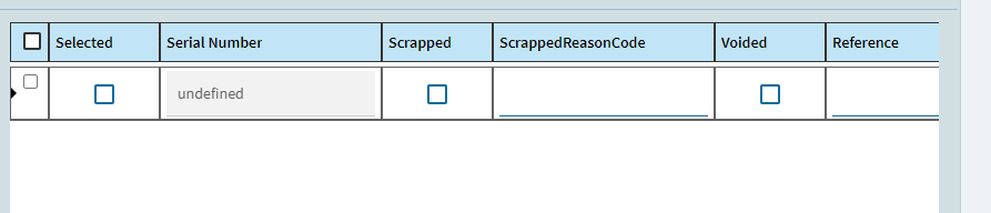

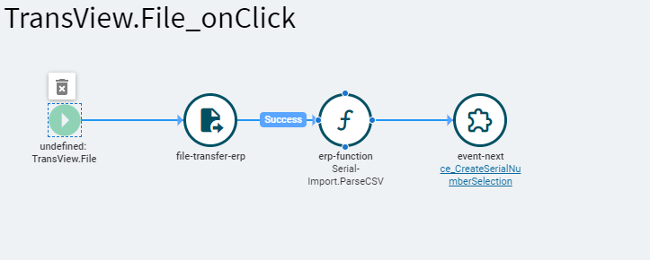

I can get it to create a row after it calls the function by using
It creates the row:

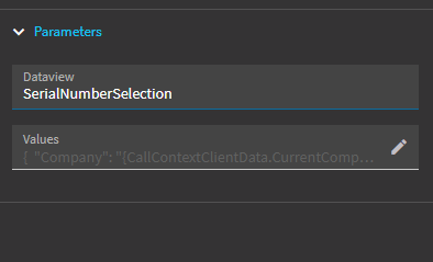

My parameters of row-add
DataView: SerialNumberSelection
Values:
"Company": "{callContextClient.CurrentCompany}",
"SerialNumber": "{FuncDS.Col0}",
"Scraped": false,
"Voided": false,
"PartNum": "{SNFormat.PartNum}",
"SNPrefix": "",
"SNBaseNumber":"{FuncDS.Col0}",
"SourceRowID": "00000000-0000-0000-0000-000000000000",
"TransType": "PUR-STK",
"PassedInspection": false,
"Deselected": true,
"RawSerialNum": "{FuncDS.Col0}",
"KBLbrAction": 0,
"PreventDeselect": false,
"PreDeselected": true,
"NotSavedToDB": true,
"SysRowID": "00000000-0000-0000-0000-000000000000",
"RowMod": "A"

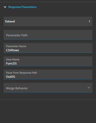

I have a CSV with x3000 lines of serial numbers and I can only make it add one. I am aware there is a foreach loop of condition-dataview but I can’t seem to get this to work correctly.

Also, please create a row manually, and lets see that dataview.

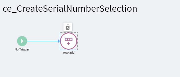

Show the eventnext properties, and the row-add properties

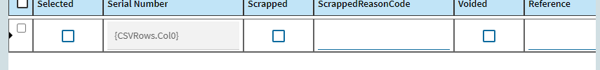

aarong
(Aaron Gulley)
March 21, 2023, 3:01pm

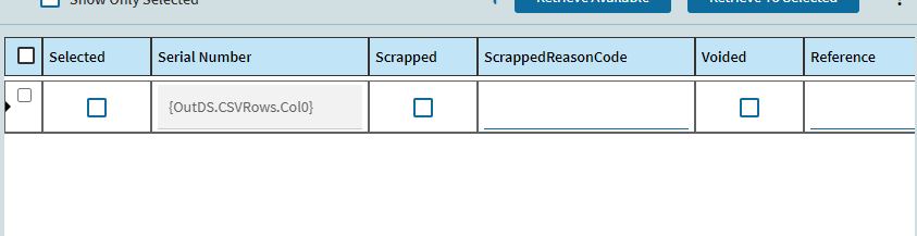

6
"Company": "{CallContextClientData.CurrentCompany}",
"SerialNumber": "{CSVRows.Col0}",
"Scraped": false,
"Voided": false,
"SNPrefix": "",
"SNBaseNumber":"{CSVRows.Col0}",
"Deselected": true,
"RawSerialNum": "{CSVRows.Col0}",
"KBLbrAction": 0,
"RowMod": "A"

Tried OutDS.CSVRows.Col0 ?

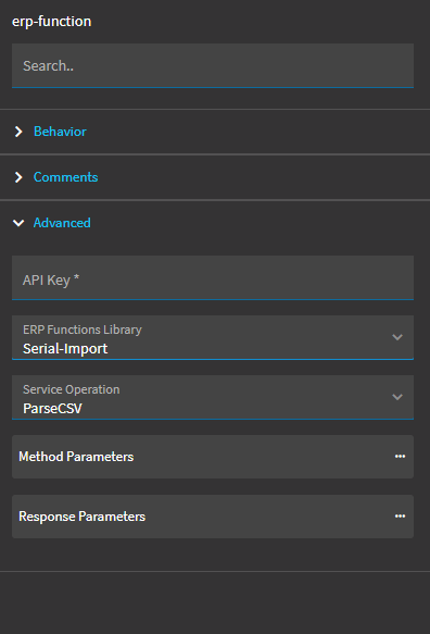

aarong:
You’ve got errors further up the chain, need to backup and fix before we start screwing with rows.
Show how you have that erp-function set up.

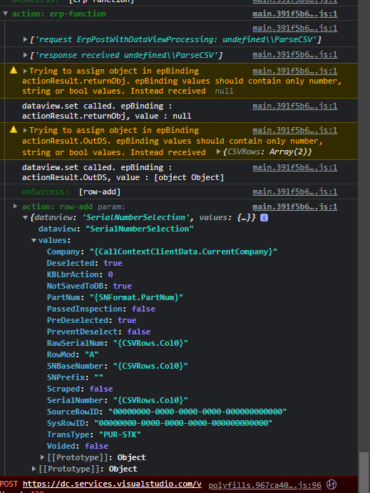

10
Those errors are normal according to @hmwillett

klincecum
(Kevin Lincecum)
March 21, 2023, 3:38pm
16
No, the properties of the erp-function widget. In app studio.
hmwillett
(Hannah Willett 🏳️🌈⚧)
March 21, 2023, 3:46pm
18
aarong:
Not normal per say, but they will show up whether your stuff is working or not. They can be a red herring and are to be ignored. I’ve never had to do anything with those errors.

klincecum
(Kevin Lincecum)
March 21, 2023, 3:50pm
20

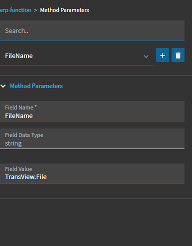

aarong:
image400×511 4.96 KB
The problem is a disconnect with this, and the reference to it in the row-add.
I don’t mess with it enough, so I can’t put my finger on it, but something here is wrong.
