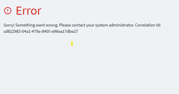

After updating the function code to above… :frowning:
what was it before ?
