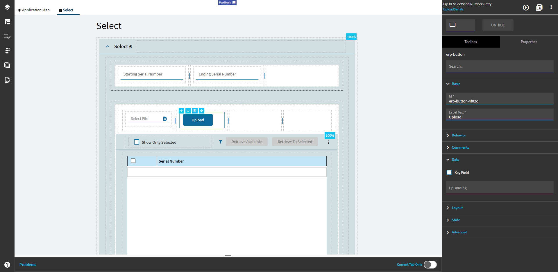

Ugh, fine. We’ll do this the hard way.
File Picker:
Upload Button:
Upload Button OnClick Event:
Iteration Event:
	"Company": "{callContextClientData.CurrentCompany}",
	"SerialNumber": "{matches.SerialNumber}",
	"Scrapped": false,
	"Voided": false,
	"PartNum": "{SelectSerialNumbersParams.partNum}",
	"SNPrefix": "S",
	"SNBaseNumber": "{matches.SerialNumber}",
	"SourceRowID": "{SelectSerialNumbersParams.sourceRowID}",
	"TransType": "{SelectSerialNumbersParams.transType}",
	"PassedInspection": true,
	"Deselected": false,
	"RawSerialNum": "{matches.SerialNumber}",
	"KBLbrAction": 0,
	"PreventDeselect": false,
	"PreDeselected": false,
	"NotSavedToDB": true

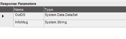

Function Code:

  OutDS = thisDS;
Where does this come into play?
