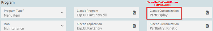

When we have both Customizations active on the menu item for Part Maintenance (only happening with this screen so far, others are working fine) it keeps reverting the Classic customization to the BaseExtension rather than the set customization. No clue why. Anyone run into this in Epicor 2022.2 and have a fix? Company 1 is not ready to transition to Kinetic UI yet and have a lot of company specific customizations on their classic layer.

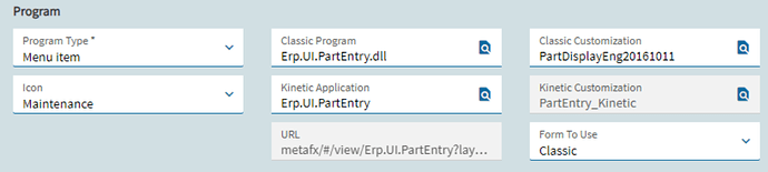

Edit - Screen is set Form to Use Classic temporarily while the Kinetic version is In Development and will turn to User Choice in October. However, we are building the layers on our Live instance so we don’t have to worry about duplicating work as far as custom fields, etc go and can just copy the db down to our test instances.
