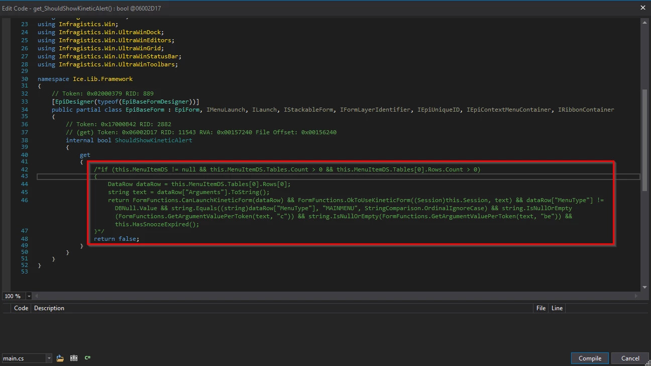

The nag bar? Oh there’s a way :smiling_face_with_horns: generally I don’t share the really hacky stuff but if you’re savvy recompile EpiClientLib’s property ShouldShowKineticAlert to return false with DnSpy and no more nag bar.

I’m going to steal that trick! Thanks @jgiese.wci
