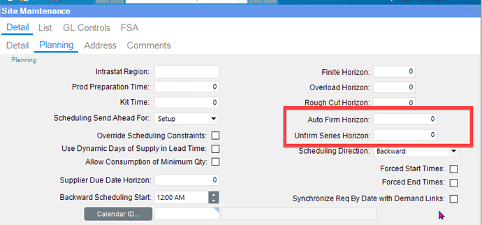

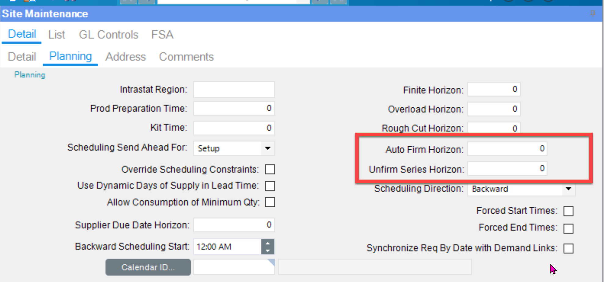

Check out Site Maintenance
For MRP created jobs - use standard functionality
Auto Firm Horizon
Specifies a number of days the MRP process will monitor to create firm jobs.
The MRP process will create a firm job if:
it’s required due date < Schedule Start Date + Auto Firm Horizon
Note: If the Auto Firm Horizon is set to zero, the MRP process will only create unfirm jobs.
Unfirm Series Horizon
Specifies a number of days from the current system date (today) where unfirm jobs created by the MRP process generate with a job number that uses firm numbering (Firm Job Prefix value); indicating these jobs are ready to engineer and schedule.
Note: Any jobs generated outside of this date range use the Unfirm Job Prefix value for their numbers.
And the best customization is no customization, like @LarsonSolutions’s solution above.
Set the auto firm to 1 week -
Create sales order for two different shipby dates
one within 1 week, one out two weeks.
Run MRP - see two jobs get created, one firm, one un-firm
