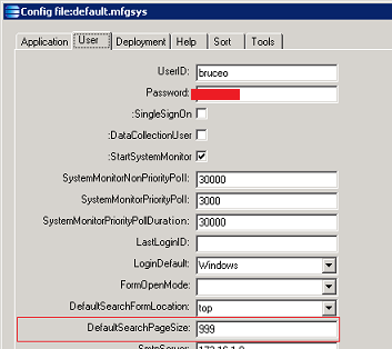

In older versions, I always set the default in the sysconfig… on MY workstation
of course I’d never to that for “regular” end users
Oh yeah, I always changed the default return to a higher number than standard but only for me too.

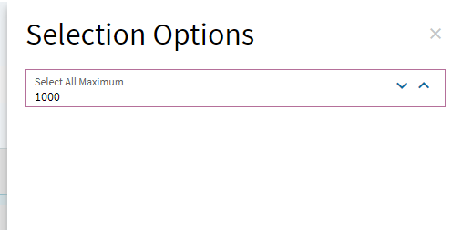

The 200 row limit should be addressed in 2022.2
Epicor are planning to re-introduce a user tunable setting that can let the user return up to the max system config setting (5k rows by default). They intentionally do not have a return all rows option as in the classic, browser returning massive amounts of data to the client can result in performance and out of memory issues. There will also be an admin config setting can override the 5k max.
Do you know if this was implemented? I have just upgraded our dev environment to 2022.2 and can’t see the setting anywhere obvious?
Found it :smiley:
