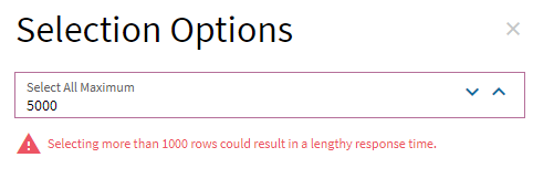

Release notes:
Change how many records automatically populate grids as you scroll down them. When you access a grid’s Selection Options, change the Select All Maximum field to increase or decrease the number of records you want to load into grids. Review the help article Personalized Searches for more information
I searched the release notes and couldn’t find reference to it (must be going daft). It does work and has a maximum set to 5000 rows which I think is reasonable.
I just tested it on new PO Suggestions. In my Dev system I have approx. 300 rows and it seems quite slow, but that could just be the environment.
But it does work which means we can think about moving forward.
I just went in an saw that it would return over a thousand records. To retrieve them you do have to scroll down - you can’t just check a box to retrieve all.
So the kinetic interface has a chance.
