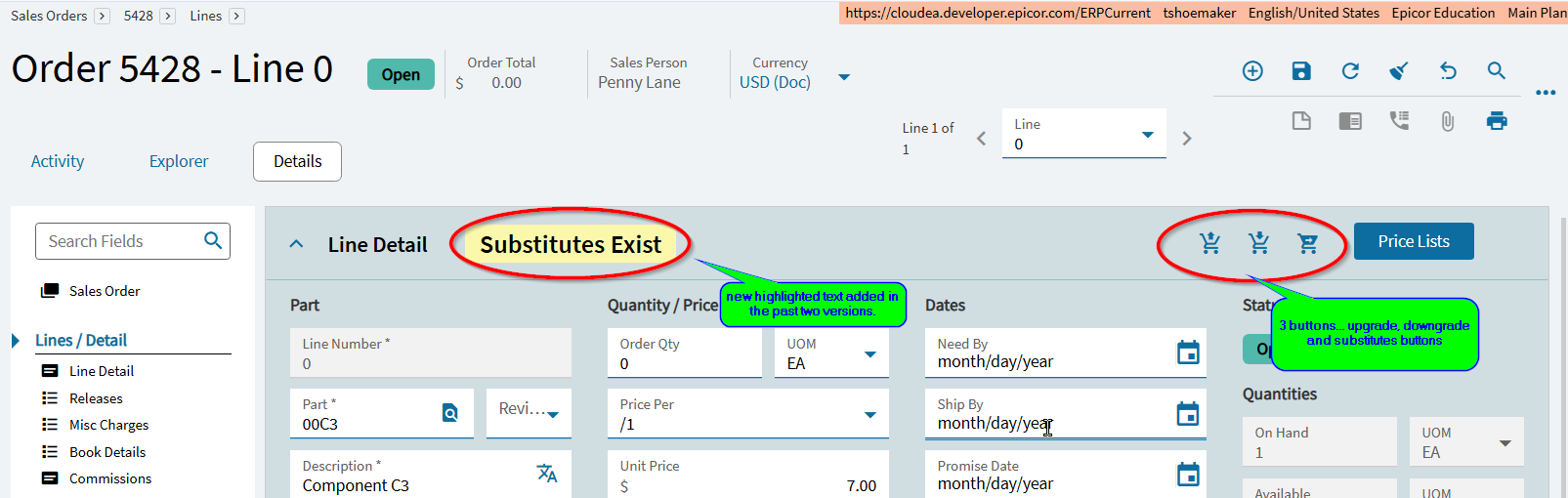

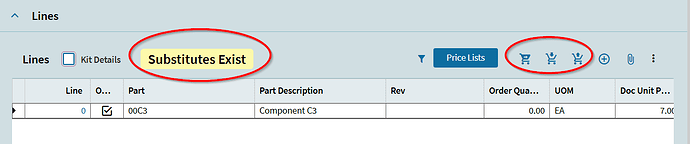

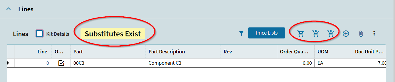

we did address a problem where it was not very evident that there were substitutes. We added the yellow banner becuase the three little icons at the right were not very evident. They USED to be right next to the part number in the smart client, but that was not practicle in the browser, so they were moved to the banner section. Here is a screenshot of the full display, followed by a screenshot of the same icons and banner in the grid view in case you enter lines from the grid.
As we said at Insights, make sure that you are on a later version (2024.1, 2024.2, or 2025.1) to get the best of all that we have done over the past 3-4 years.

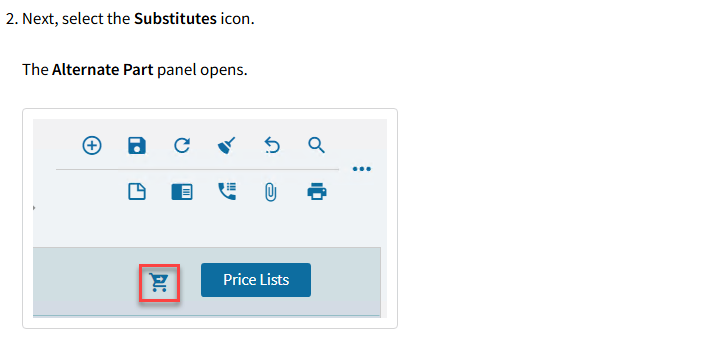

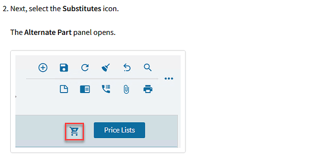

Ah, found it in the help but not in the Adding Lines Section:
https://erphelp120100.zendesk.com/hc/en-us/articles/36506675468941-Creating-Sales-Orders#Working
I’m glad you said something @timshuwy. PRB0292322 is still open so I had no idea this feature was completely fixed. Just tested in 2025.1 and it works great. Thanks!
