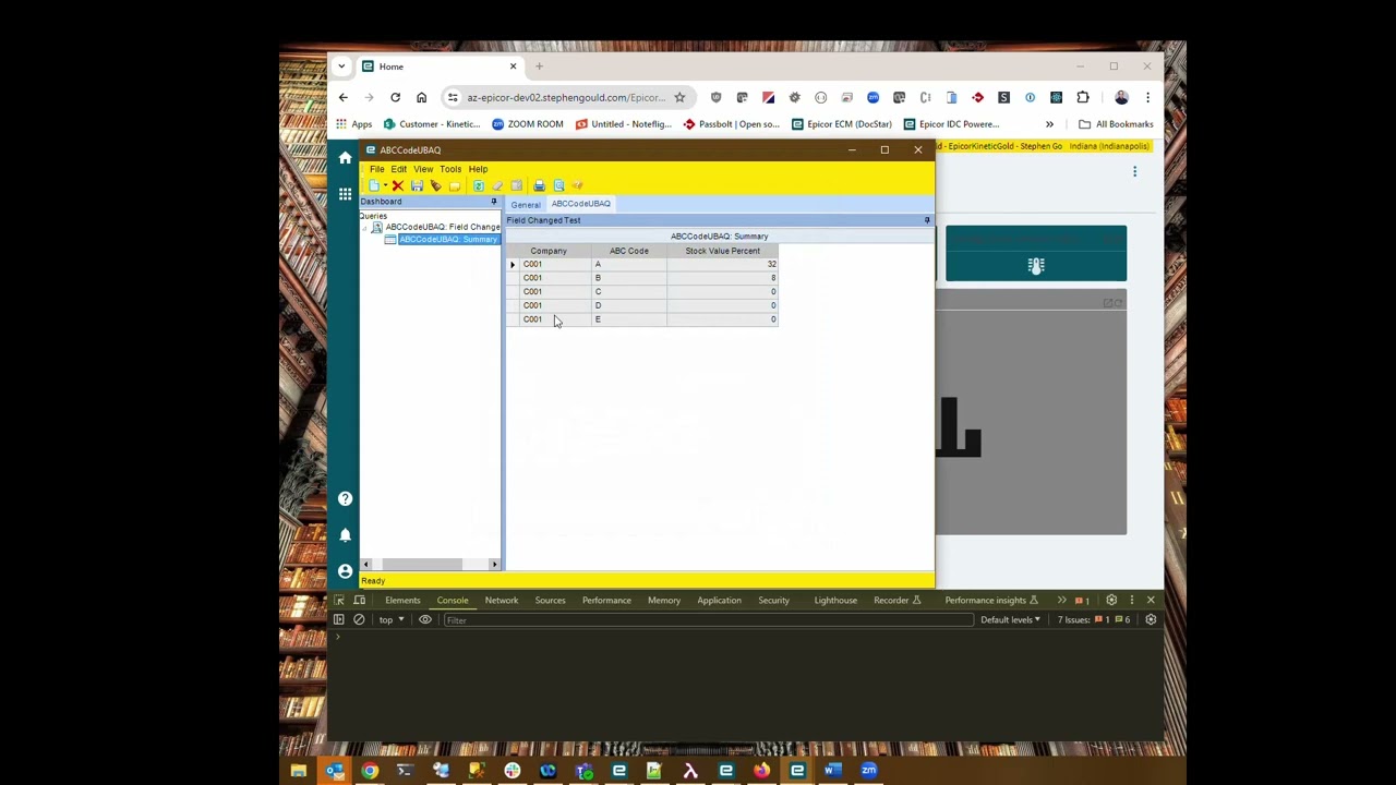

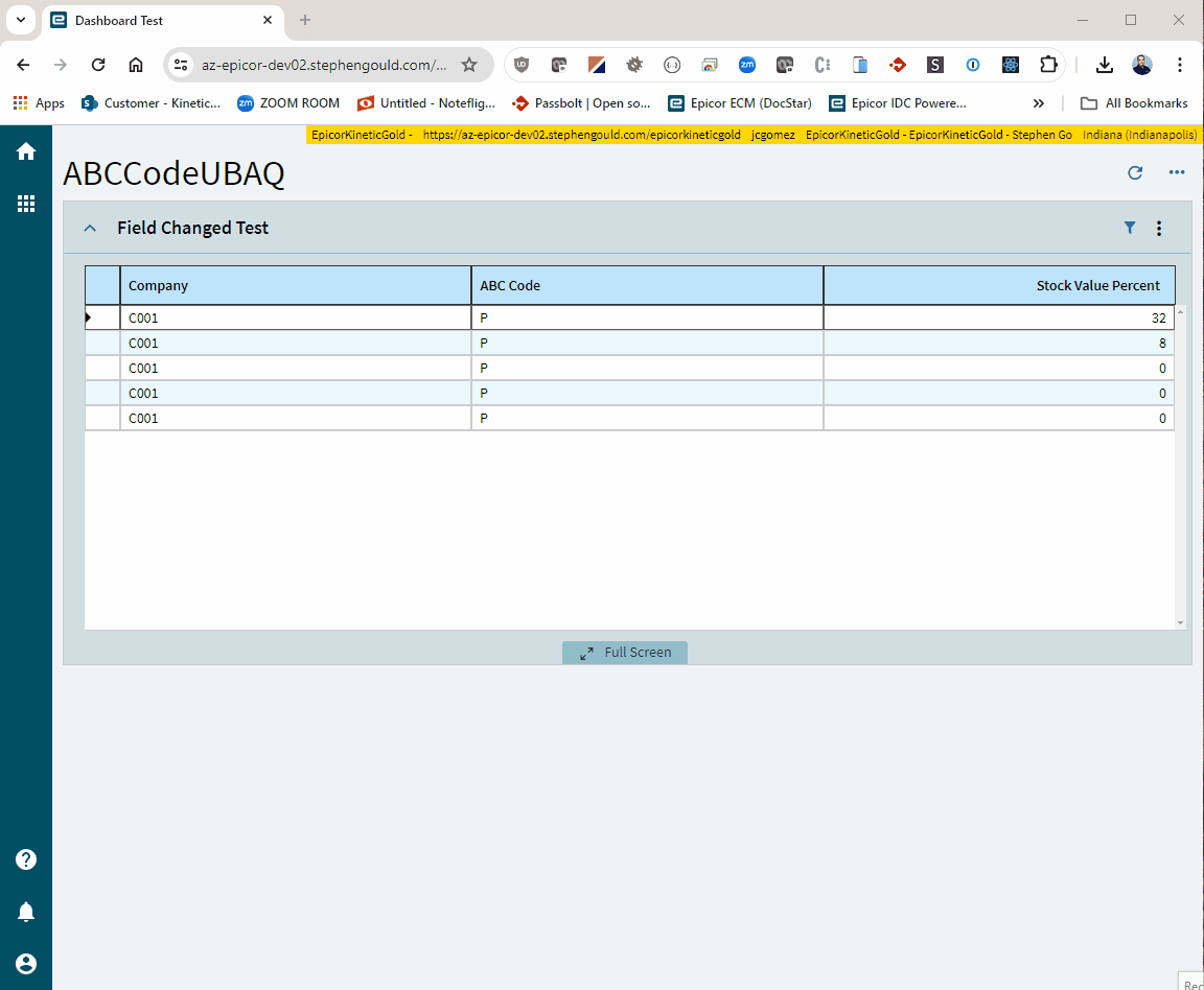

Here’s a Demo of the Issue @Olga
I will open a ticket on the CR for this too @adupuis-nadeau see if we can get some traction.
