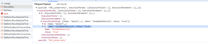

I am developping a dashboard linked to an updatable BAQ that has a post-Process BPM on the GetList.
On the first refresh of the dashboard the GetList BPM is triggered so my column filled by the BPM are correct.
But when I need to click back on refresh the values are no more there in the columns.
I found in the netword in developer console the second time we refresh there is this execution settings param: Name: “SkipBpmOnGetList”, Value: “true”.

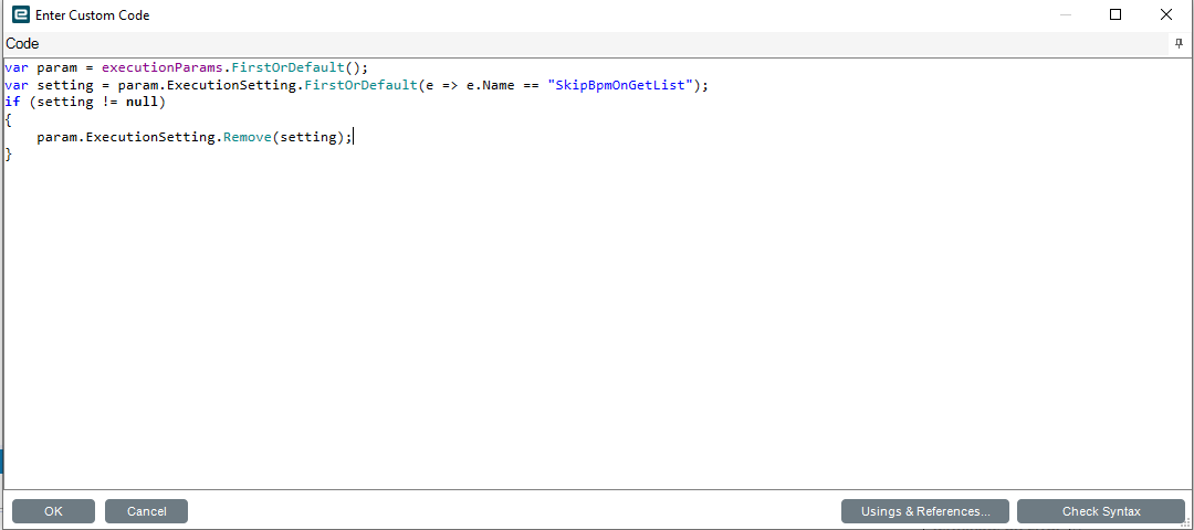

You might want to put some criteria restrictions on that, at least for now, limited to maybe certain BAQs, until we know what this “feature” will affect.
We have the same issue within the smart client. I just found the reason within the broser on why on second refresh my values disapeared.
I dont know why but in the payload it send the SkipBpmOnGetList = true parameter.
We should have a way to remove this param in the dashboard maintenance or just that it stay to false by default I dont know any reason why we would want the getList BPM to not be triggered.
