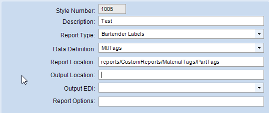

HI Ryan, can you provide me with some more information or a quick phone call to discuss how you pushed the report styles to bartender? We are also a cloud client but we have a bartender server onsite. When I try to modify the output locations to our bartender server in the report style I get an error stating invalid output location.
Your output location needs to be an epicor ftp share or an epicor azure file share.

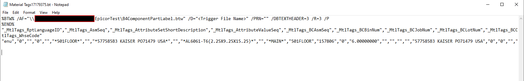

Thank you! I took a shot in the dark and figured this out before seeing this. I noticed the file that saves on the server has two lines before the header line. For bartender is anyone utilizing these two lines or are you just skipping them when setting up the database connection in bartender?
Hi Christian,
Can you share an example possibly? I’m not sure what you’re referring to with the two lines before the header.
Here ya go!

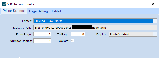

When I select a different report, I get the SSRS Network Printer Popup.
Do you see anything when you click this little black arrow? Like two options, one that says “client” and one that says “network”?

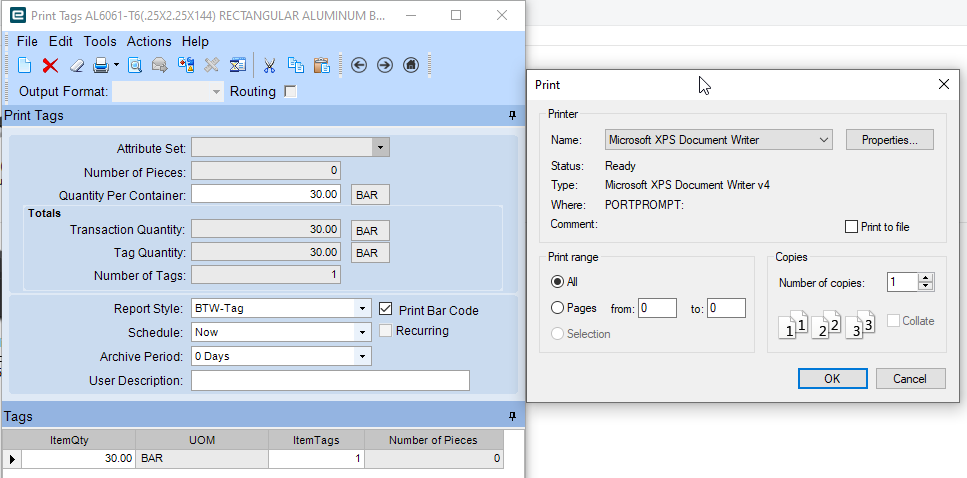

Yes, when I see that dropdown arrow and I get both “Network Print” and “Client Print”. Under the standard ssrs and reports the Network Print option populates the SSRS Network Print window as seen in the 2nd screenshot. If I choose my BTW Report Style both options show the client representation in the first screenshot. I could work around this by installing the label printers on all the necessary computers so that it populates the correct printer under the bartender command but if I can get the network print option to populate it is a much easier option to implement.

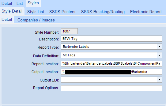

@klincecum - Isn’t this entire thread about pushing SSRS MtlTags info to a bartender server? I used information from @TyrusRechs and @JasonMcD write ups to get this working. Instead of using BPM to push the data to Bartender, I am sending the data via the report style seen in the screenshot below.
@rholndoner - Me neither, In @TyrusRechs write up he shows he is selecting the printer he added to printer maintenance. These printers populate when you choose the “Network Printer” Drop down as seen in the screenshot directly below. If I choose our standard report styles and choose network printer, I get the below SSRS Network Printer popup.

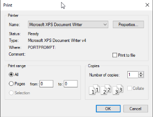

However, if use my Bartender report style and click the network printer drop down it does not give me this option. It instead gives me the below screen shot.

@utaylor - Yes, this is all to get the .bt file to populate with the correct printer in the print command that is being sent to my bartender integration.
