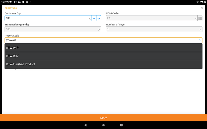

We were able to get the Print Tags button in EKW to print bartender labels. We deployed 50 tablets to the shopfloor so it was critical for us to figure out. It was not easy to set up and it’s not well documented. We’re a cloud customer so it was even more difficult but it really works well once all of the setup is done.

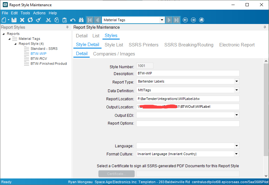

If you haven’t done this yet, the MtlTags report needs to bet set up with a Bartender print style:

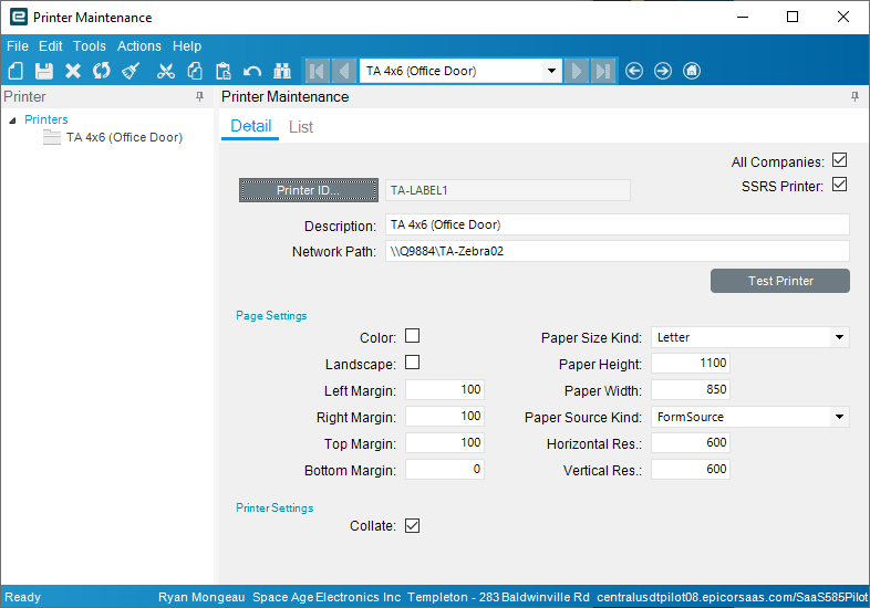

The label printers need to be added via Printer Maintenance and set as SSRS printers (yes, even though they’re not printing an SSRS report), and they need to be added to whatever server you have the Bartender integration installed on:

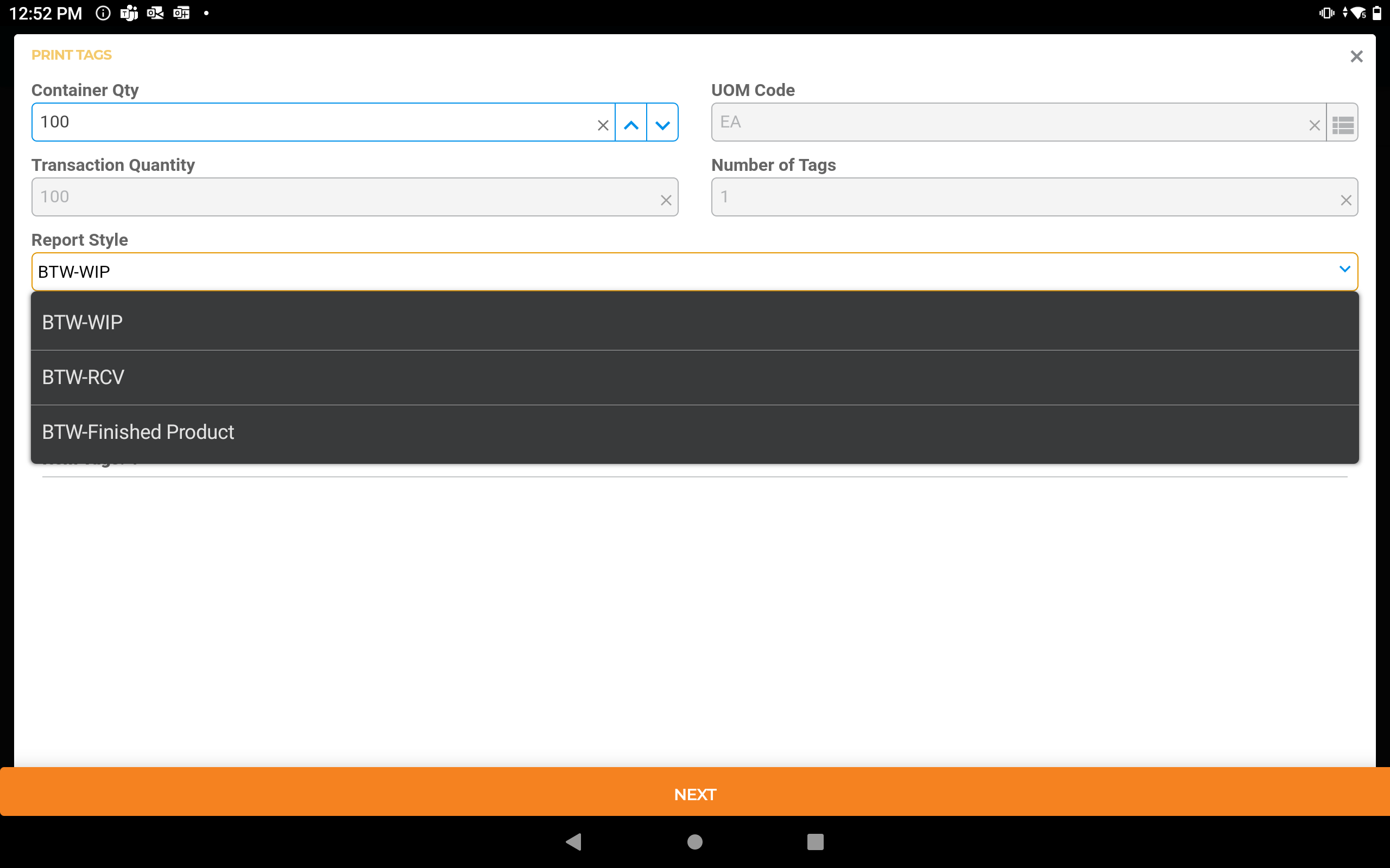

The downside is that depending on what the transaction type is, you have to select the correct report style every time. We have a WIP tag for ending production on a job, a receiving tag, a part ID tag, and are working on more.

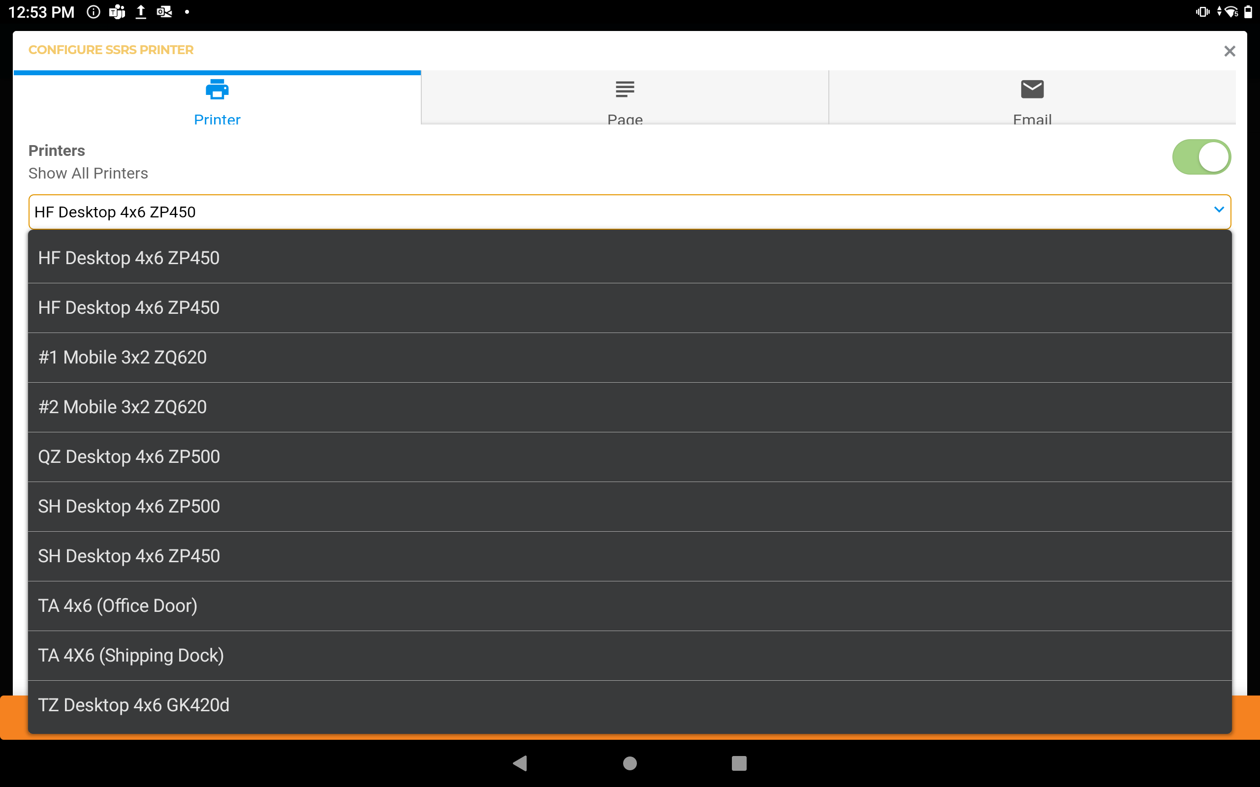

Additionally, you have to select the printer every single time as well which causes some confusion as well:

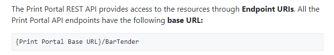

I just installed BT 2021 and am trying to learn the API thing. I see on their site to call this:
But what is this base URL? Do I need to do other setup first?
Edit: never mind. I see now. We have Automation and not “Enterprise Automation.” Not confusing at all.

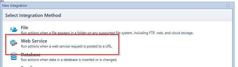

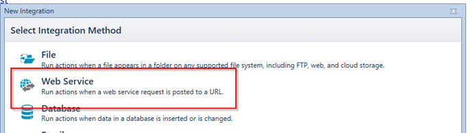

Do you have Integration Builder with your version? If so, create a new Integration and see if you have an option for

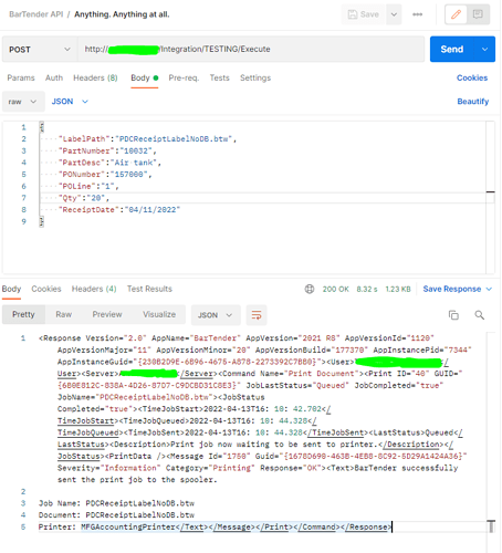

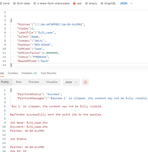

In terms of accessing the API, this is the entirety of the custom code block I put in a BPM that fires off when a specific job op is completed.
For your integration, just just have to swap in your bartender server name and the name of your integration in the uri variable at the top. The rest is configuring the loop or lookup to your specific case.

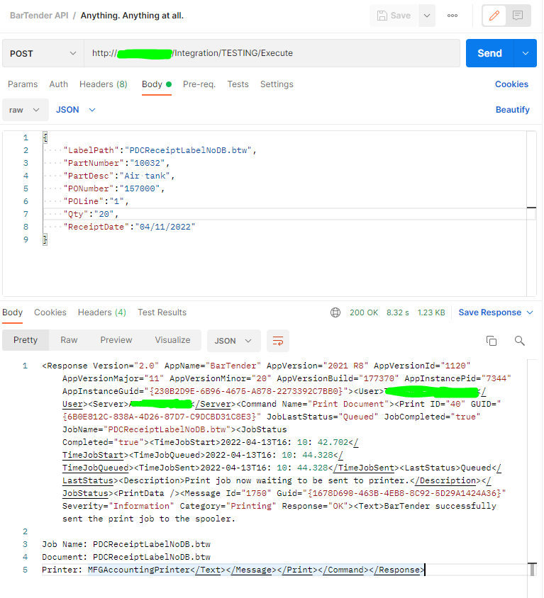

So this does get me outside of the BT docs with Print Portal (and presumably the Swagger page as well), but I will take what you have sent and start testing.

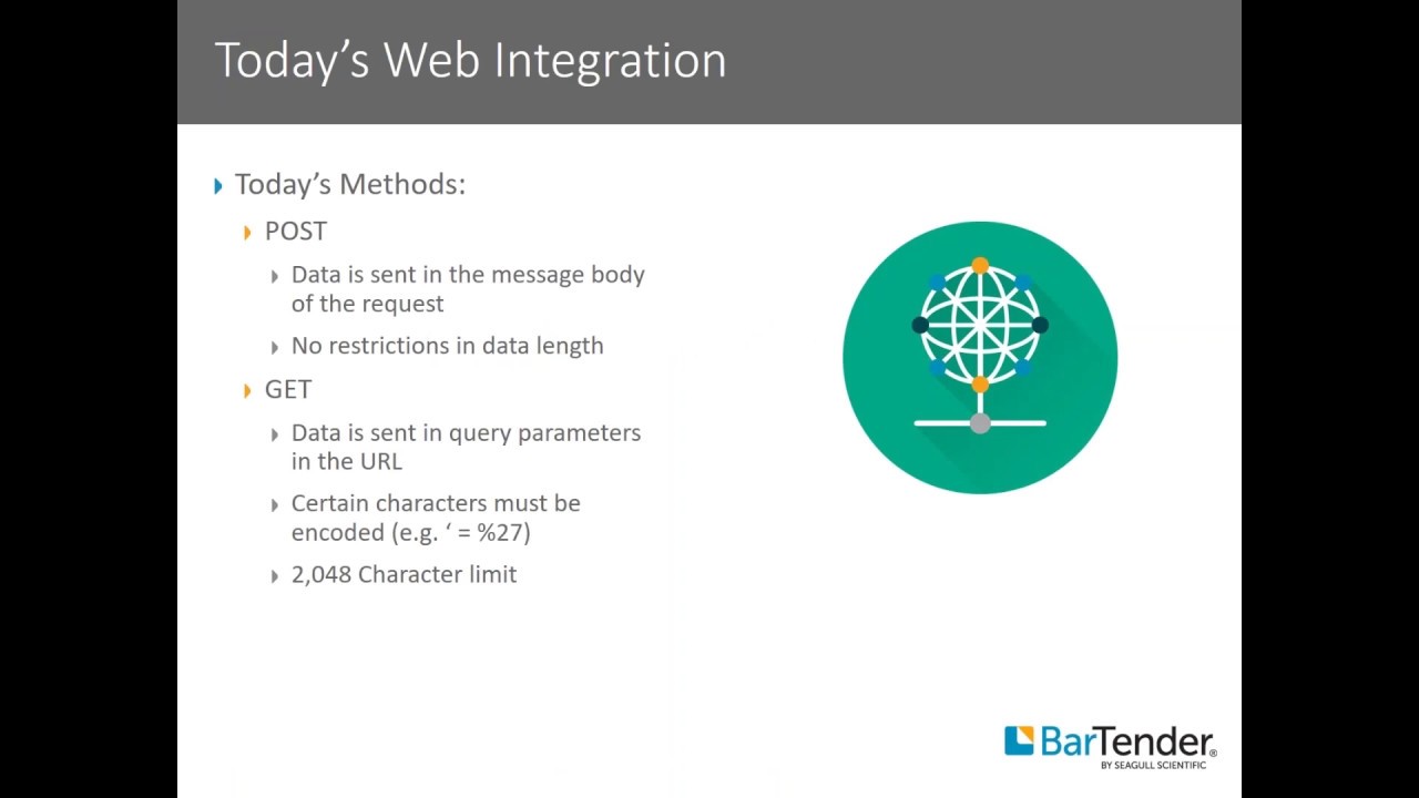

A few generic tips to start:
Dont try to get fancy with auth until you are done developing\testing
You can use POST or GET - use POST, it’s more flexible (send params in body)

So, this is just really ordinary BarTender stuff that you can learn about on YouTube…
OK, so I haven’t got into the Epicor side of things, but this looks… easy?
Definitely not rocket science, slight learning curve but still easy enough that everyone should be using it over file drops for sure!

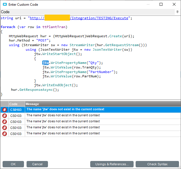

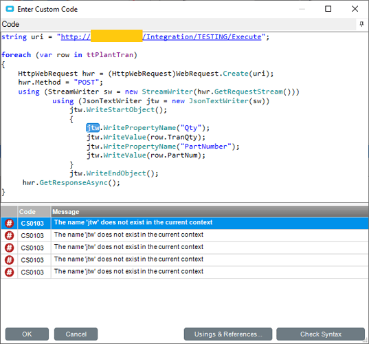

@jtownsend I am trying your code, but get these errors - like a scope issue or something:
I did add these already:

You might need to bracket everything within the using statement.
 using (JsonTextWriter jtw = new JsonTextWriter(sw))
                jtw.WriteStartObject();
                    jtw.WritePropertyName("sn");
                    jtw.WriteValue(row.SerialNumber);
                    jtw.WritePropertyName("pn");
                    jtw.WriteValue(row.PartNum);
                jtw.WriteEndObject();
And Newtonsoft.Json is the only additional module required.
