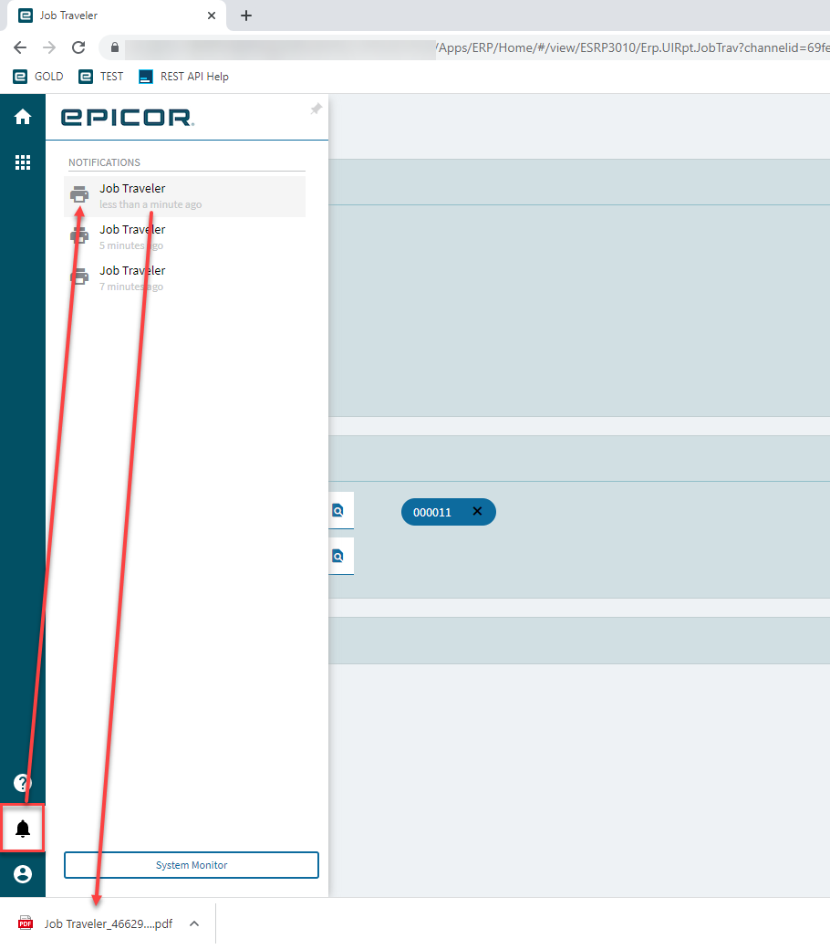

From my brief testing, it doesn’t pop up on mine automatically either, but if you go to the notifications, you can click on it to download it.

I still can’t get a pop up but if I click on it in notifications it shows at bottom but as a Text file not PDF. In the old versions they always defaulted to PDF file as a print preview.
I have the same issue. I changed the file to .pdf and now every subsequent one is pdf.
Never mind it’s back to txt.

Thank you, well they told me you can’t print preview it from the browser if I understood the KB correctly.
You have to use the notification section to download the file first.
