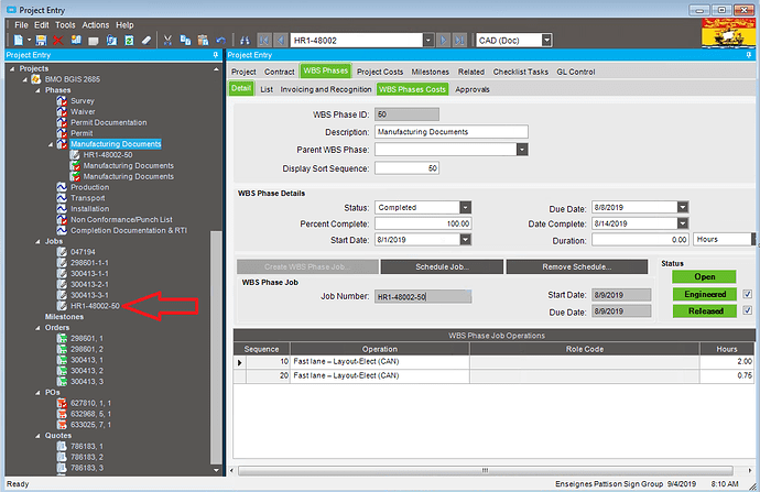

We use Project Entry. A project is created with a WBS Phase job for the pre-production tasks such as Engineering, Surveys, Manufacturing drawings, as well as project management itself. The sales order line, manufacturing job and purchase orders are all linked to the project.
Interesting, and this would allow the “costs” to be billed to a job? Like the engineer’s time before the jobs are dropped?
Yes, the costs would go to the Project Job,
Project jobs cost does not get applied to the sales order line though. If you are engineer to order, and the cost of engineering is part of your margin calculation per sales order line, it will not apply. Project jobs are considered overhead I believe.
We did make some changes to our posting rules to accommodate this.
