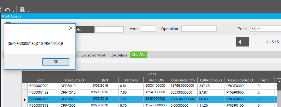

I am passing these params to GetNewLaborDtlOnSelectForWork:

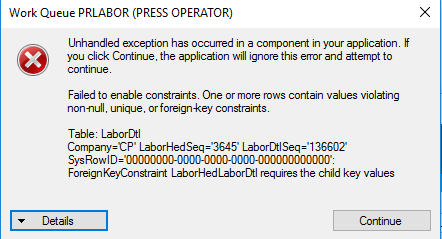

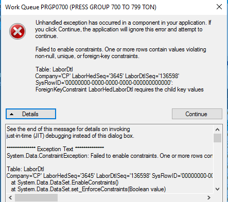

And I get this wonderful exception:
That exception happens only once. If I try again it doesn’t occur (although I am still getting “Labor Header has not changed”)
What params… paste the code…
adapterLabor.GetNewLaborDtlOnSelectForWork(Convert.ToInt32(lbr.Tables[0].Rows[0]["LaborHedSeq"].ToString()),epiUltraGridJobs.Selected.Rows[0].Cells["JobHead_JobNum"].Text,Convert.ToInt32(epiUltraGridJobs.Selected.Rows[0].Cells["JobOpDtl_AssemblySeq"].Text),Convert.ToInt32(epiUltraGridJobs.Selected.Rows[0].Cells["JobOpDtl_OprSeq"].Text),epiUltraGridJobs.Selected.Rows[0].Cells["JobOpDtl_ResourceGrpID"].Text,"B",out prompt);
3645, “F000007486”,0,10,“PRGP0500”,“B”
Interestingly, I noted the error title referenced the wrong resource group so I removed some other test code where I was selecting the group in the title. Now, the error title is:
Oooh, maybe I need to pass the resource group of the Employee :blush:
Nope - No change. :cry:
Table: LaborDtl
Company=‘CP’ LaborHedSeq=‘3645’ LaborDtlSeq=‘136612’ SysRowID=‘00000000-0000-0000-0000-000000000000’: ForeignKeyConstraint LaborHedLaborDtl requires the child key values (CP, 3645) to exist in the parent table. —> System.Data.ConstraintException: Failed to enable constraints. One or more rows contain values violating non-null, unique, or foreign-key constraints.
It thinks that the LaborHead doesn’t exist…

I am going with:
var lbr = adapterLabor.GetRows(opts, out more);
lbr.Tables[0].Rows[0][“RowMod”] = “U”;
No apparent change. Let me check the trace.
Sure! However you can use the typed dataset to make your life easier, using quoted strings is error prone
LaborDataSet lds = adapterLabor.GetRows(opts, out more);
lds.LaborHed[0].RowMod="U";
