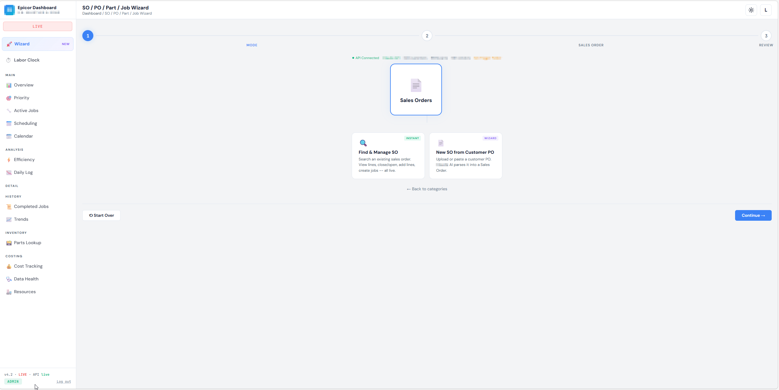

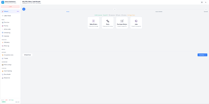

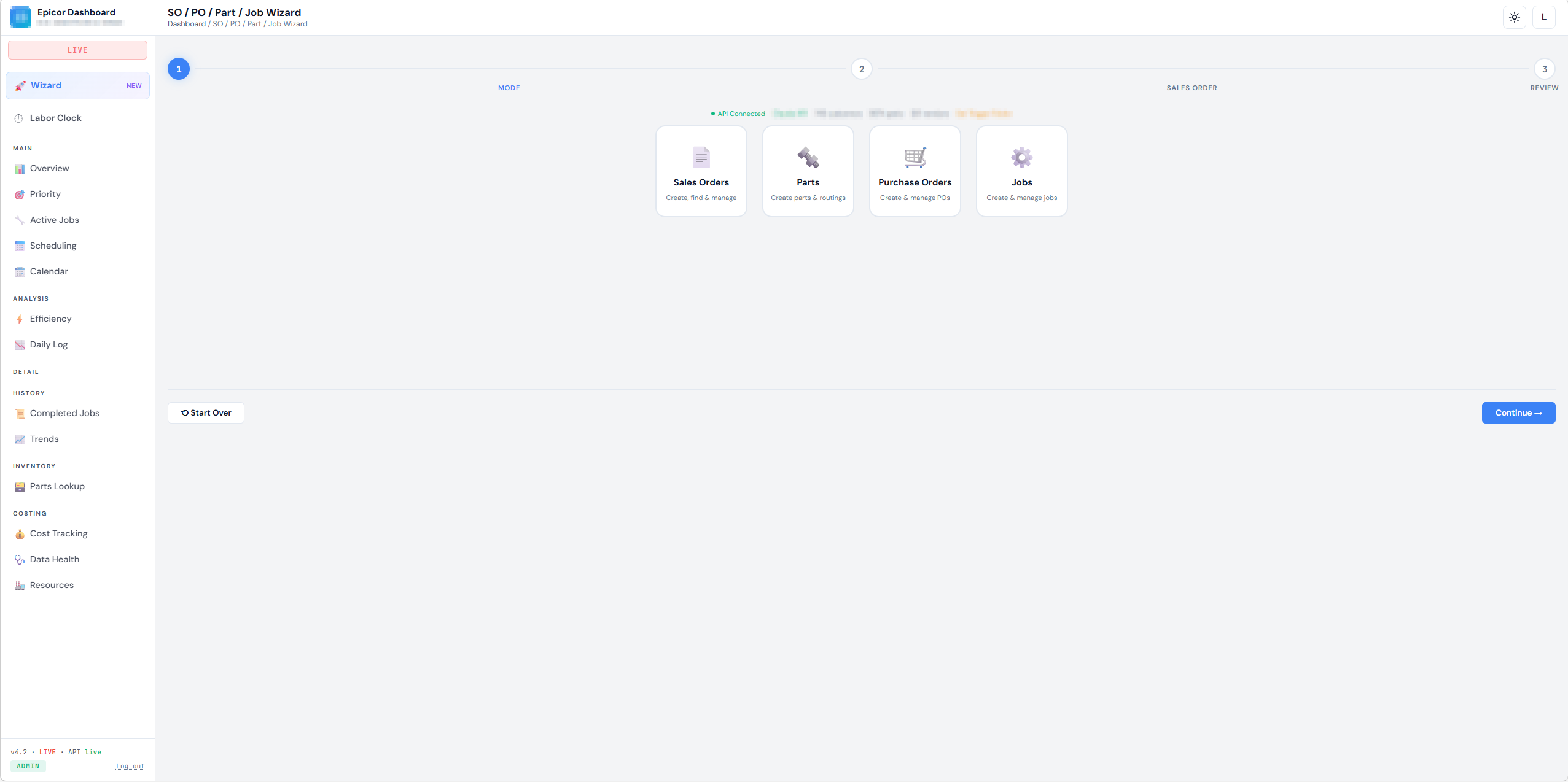

This is probably the least visually organized part of the dashboard, but here is one of the sections that integrates with Epicor via API, and via PowerShell (for some of the DMT function - as this allows me to give other users access to some of the convenience of DMT but with validation applied to what they input). I think it’s mentioned somewhere - I have found a lot of backdoor/workaround stuff necessary due to certificate issues and the lack of an actual multi-user set up. Everything is currently local on my device and living in an .html page.
A lot of it is charts and typical “ops stuff” (OTD, Capacity, etc.), but much of it is limited until I can realign some of our data entry practices (there is an “under development” health section to help me see some of the easily catchable offenders)

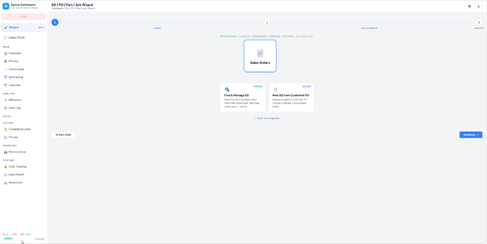

When Wizard is selected:
When Sales Order is selected:

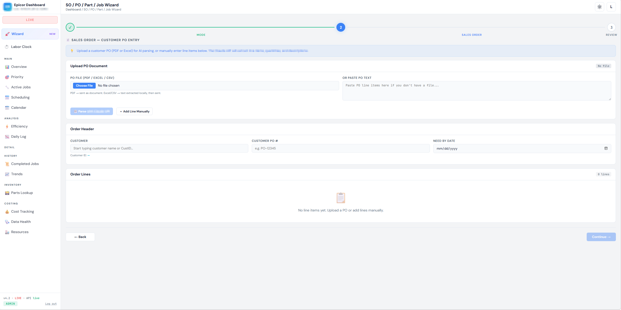

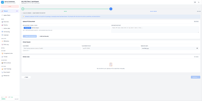

Where a PO can be uploaded and parsed via API: A user drops in a file, and a basic prompt structure the data to how we enter SO’s, then either the API or DMT is called (I forget which is engaged here…) and the SO is entered. Probably not the most effective way of doing all of this but lightning fast compared to our previous methods.
