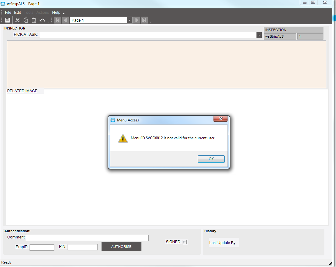

Hi @josecgomez.trigemco, thanks for your prompt response. Tried calling the Job Tracker menu
Ice.Lib.Framework.ProcessCaller.LaunchForm(this,“SVGO0012”);
But system raised error saying “menu id not valid for current user”. there is no security restriction in our system for job tracker . anyone can access it. Donno why it says that error. It is the same case if i call any other menu item from main menu or process menu.

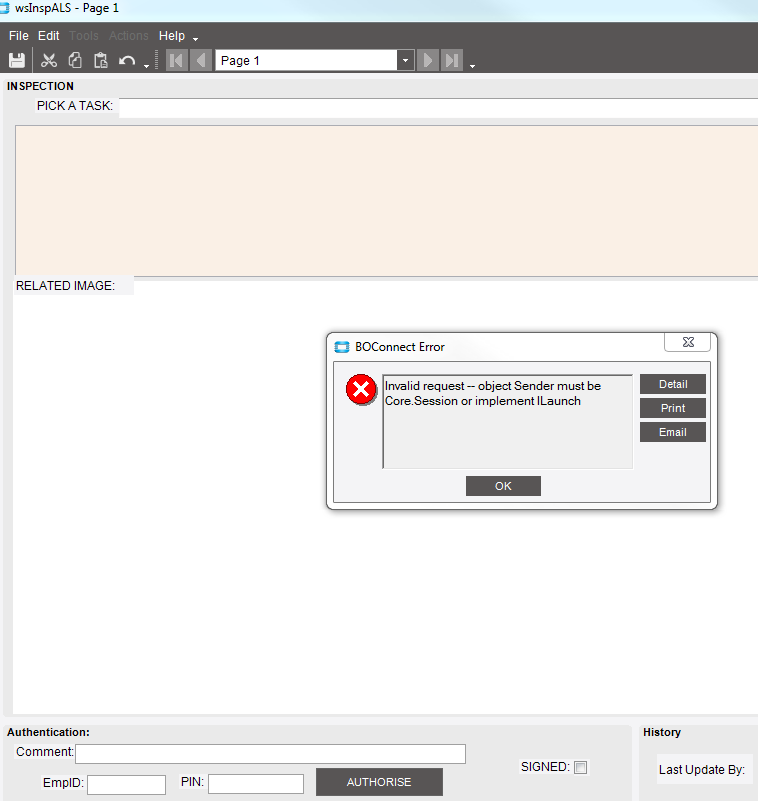

therefore tried calling the form as
Ice.Lib.Framework.ProcessCaller.LaunchForm(this,“Erp.UI.JobTracker.dll”);
system raised error saying “Invalid request – object Sender must be Core.Session or implement ILaunch”
(Exception caught in: Ice.Lib.EpiClientLib
Error Detail
Message: Invalid request – object Sender must be Core.Session or implement ILaunch
Program: Ice.Lib.EpiClientLib.dll
Method: GetSessionFromSender
Client Stack Trace
at Ice.Lib.Framework.FormFunctions.GetSessionFromSender(Object sender)
at Ice.Lib.Framework.EpiBaseAdapter.get_Session()
at Ice.Lib.Framework.EpiBaseAdapter.BOConnect()
at Erp.UI.App.JobTracker.Transaction.TransactionLoad())
because the error clearly says it needs session object, thought I may need to use ILaunch out of EpiClient dll. therefore, copied across the EpiClient dll to server assemblies and played with it. however, you clearly mentioned no object exist in configurator and that dll has lot of dependencies. I agree with it. I removed that dll.
