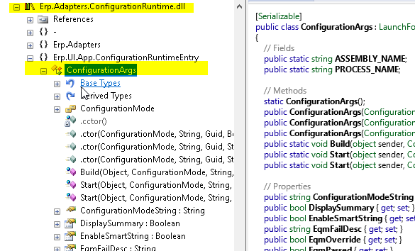

Thanks. I’ll give it a try. I think it is looking specifically for this type: Erp.UI.App.ConfigurationArgs as the param. I cannot locate where the class is located.

Thanks. I thought I have referenced all the DLLs. I see the class now. Will play around with it.

Here is my code (that gets to a certain point then throws an error ) – I am plugging in some hard-coded value just to try to get it to launch.
Guid rowID = System.Guid.Parse("551DABBB-DC2C-4411-8E66-55F3D069CAA9"); //Part_Row.CurrentDataRow["SysRowID"].ToString());
	Guid foreignSysRowID = System.Guid.Parse("8350D2FE-E6F3-49AB-9C19-01B01F8C7D40");
	Erp.UI.App.ConfigurationRuntimeEntry.ConfigurationArgs args2 = new Erp.UI.App.ConfigurationRuntimeEntry.ConfigurationArgs(Erp.UI.App.ConfigurationRuntimeEntry.ConfigurationArgs.ConfigurationMode.Production, "Part", rowID, false, "", "", "");
	args2.SourceKey = new Dictionary<string, object>() { { "SourceSysRowID", "152204A5-A01C-435B-A539-C3FB544B996C" }};
	args2.SourceTableName = "PartRev";
	args2.RelatedToTableName = "Part";
	args2.RelatedSysRowID = rowID;
    ProcessCaller.LaunchForm(oTrans, "CON1000", args2);
