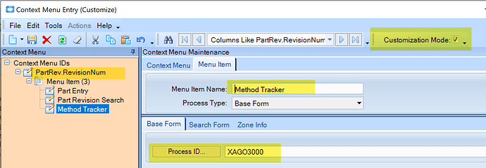

When you are in the Part Maintenance screen, the Context Menu option for the Method Tracker on the Revisions page is hard coded. (No idea why.)
If you go into the Context Menu Maintenance screen and pull up PartRev.RevisionNum add a new Menu Item and call Process ID XAGO3000.

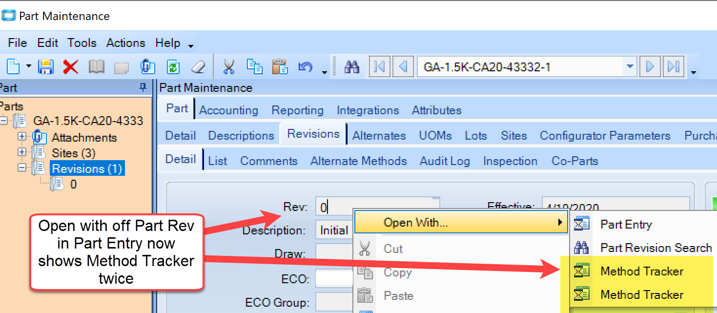

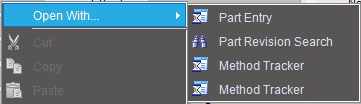

The only problem is that the Part Maintenance Revision context menu will look like this.
Where the Method Tracker Revision context menu will look like this.
Well, using the context menu with XAGO3000 opens the Method Tracker.

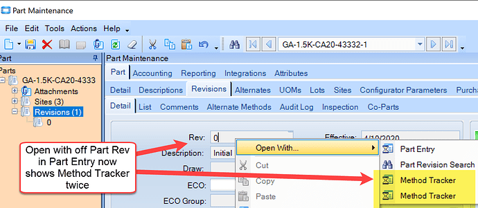

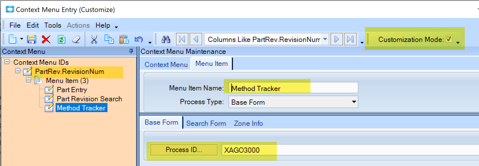

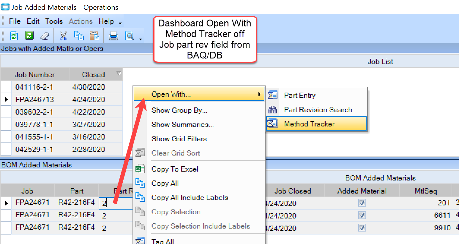

So Nate, I have a dashboard that pulls JobMatl and JobOper data in and I wanted to do an “open with” in the dashboard on the part revision field in the JobMatl and JobOper data (second screenshot below). Per John’s context menu suggestion (first screenshot), I added Method Tracker to the PartRev.RevisionNum menu (NOT the PartRev.RevisionNumber menu), per below. Now I have the “open with” off of a PartRev field from the Job header /matl data working. I did at one point also have it open the engineering workbench instead of the Method tracker. I’m not sure how it got fixed, perhaps I was trying to use the PartRev.RevisionNumber context menu, or I didn’t deploy assembly. I lost track when I was so excited that it worked!
One other thing, the addition of the Method Tracker to the PartRev.RevisionNum does show it duplicate on my open with from part entry similar to John’s post (screenshot 3). It doesn’t seem to hurt so I think I’ll just tell anyone who asks to use either, it doesn’t matter.
