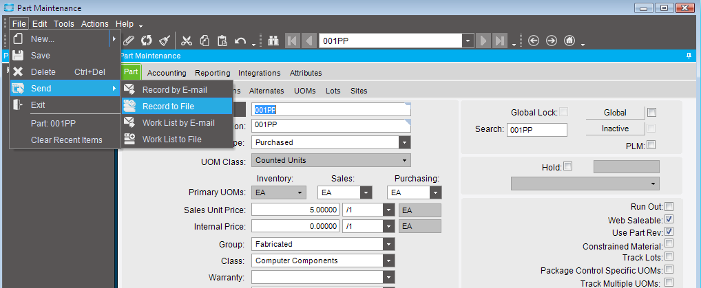

Or You can use “Record to File” option from menu File in any Epicor Windows, this option generate a .sysconfig file with all parameter, later you must open using epicor.exe program

Oh, very nice! I didn’t know the Record to File existed. Depending on the file type it saves as, I should be able to associate that file type with Epicor.exe on the computers that I’ll be executing this code from. This might be just what I’m looking for, though I may have to play around with injecting a PO Number, for example, into the stream, but it’s a great start, thanks!

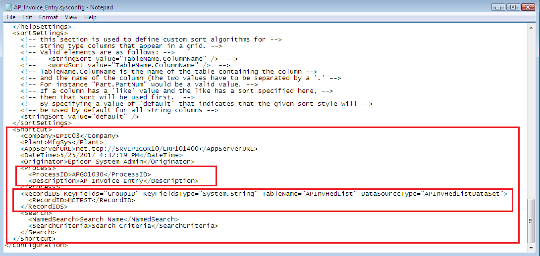

Basically, the .sysconfig file is a XML, and at the end of file are settings for shortcut to open the menu option and the record too.
the screenshot example its for open the group ID “HCTEST” in AP Invoice Entry window
Yes, you can associate the sysconfig file with Epicor.exe, or you can config an Epicor shortcut icon using the Epicor.exe patch and /config=myrecordtofile.sysconfig

[RecordID]200002[/RecordID] looks like the way to pass the record into the .sysconfig file after doing a little testing. (Edit: I just realized you did that with HCTEST)
I will code my webpage to build the .sysconfig file dynamically depending on what’s clicked with the appropriate RecordIDS and RecordID inserted. The user will then be prompted to open the .sysconfig file, and after associating with Epicor.exe, it should work perfectly. As a bonus, it appears that it will open the .sysconfig file without creating a duplicate instance of Epicor.exe if the program is already running.
