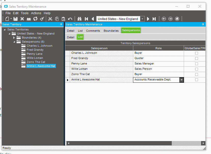

So in a typical IT type moment a user complained to me that in Sales Territory Maintenance that Sales Rep List wasn’t sorted properly. They wanted it sorted by Sales Rep Name.
I gasped exasperated, pontificated about the wonderful feature of Epicor which allows you to sort any grid and save that layout, went on about how we’ve had training on this, and hung up.
Got called back “it is still not sorting right”, rolled by eyes, told them to “prove it” and this is what I see…
Thanks Epicor for making me be a jerk… (more than normal) I eventually did figure out what the issue is, embedded drop-down in the grid shows name, but it sorts on Sales Rep Code… sigh

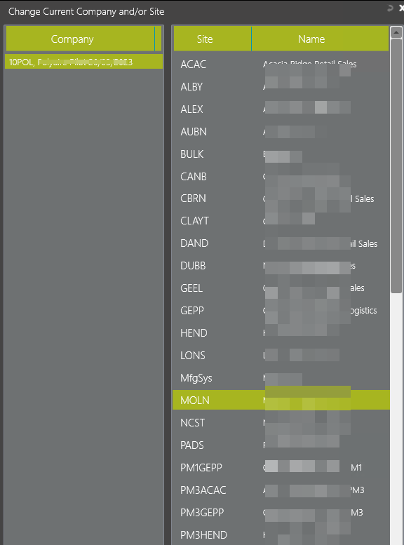

Any suggestions on applying this to Plant.CostID? We need to change the order of the plant selection list. I’m struggling to work out how that even loads… Ice.Plant perhaps?
Here it is in Kinetic
Sorry for the obfuscation. Essentially the list is the Descriptions /Names of the sites, but they are ordered in the Site ID order.
And yes if we had our time again site ids would have had some more though put into them prior to setting them up. It would be really useful for either Sites to have a sequence number or at a pinch use the site cost id. to order this list by.
Of course this hack does not replace making a thoughtful approach to configuring your system correctly in the first place. That being said it would be nice to have a sequence number for plants and be able to sort on that, rather than the Plant field.
