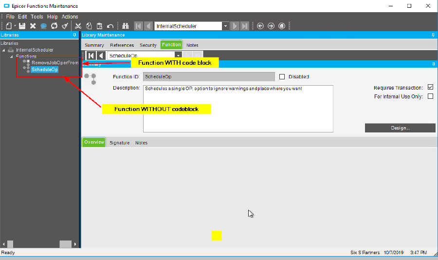

For posterity, dont make the same mistake I did…
When simply clicking the NEW button on a library, it will create a" function WITHOUT code block". So dont freak out when you dont see a code block in a designer after making this mistake haha, (Note the different icons)
I have good company then. The FIRST time I used Functions in an early internal POC, I made the same mistake.
