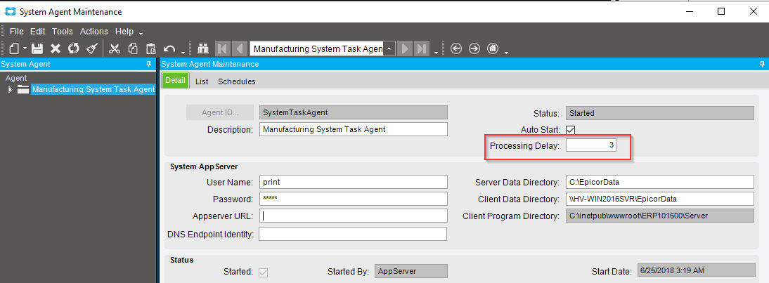

- Requires an active user session at the time the report is scheduled to print/print preview to completely process.

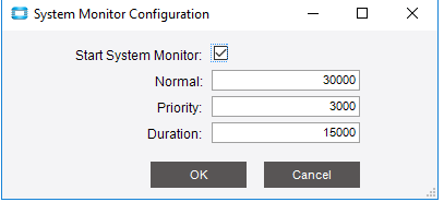

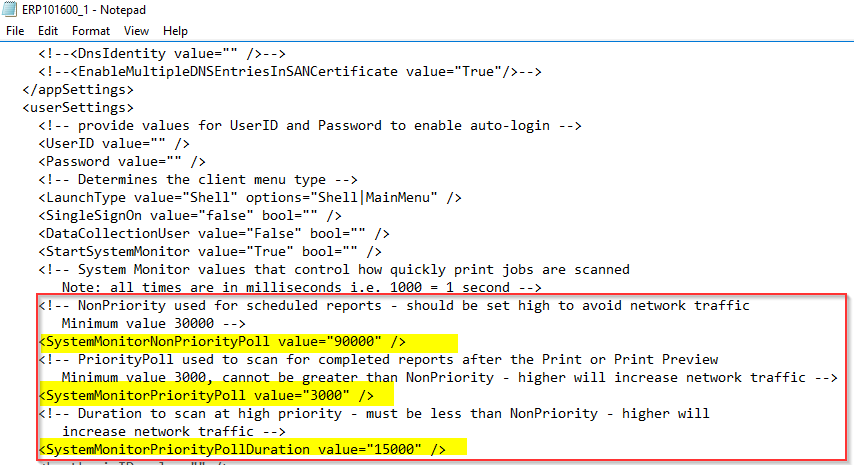

- There is a polling process that executes every X seconds from the client-side so there is increased processing time as the report is returned to the client.
- For reports that process very quickly (e.g. labels), the added 0.000000000001 to ~3 seconds of processing time that the polling introduces can make up 50%+ of the total time to printer.

- For reports that take two hours to process, the added 0 to 30 seconds delay that the polling mechanism introduces may not be that big of a downside considering the added complexity of server-side printing.

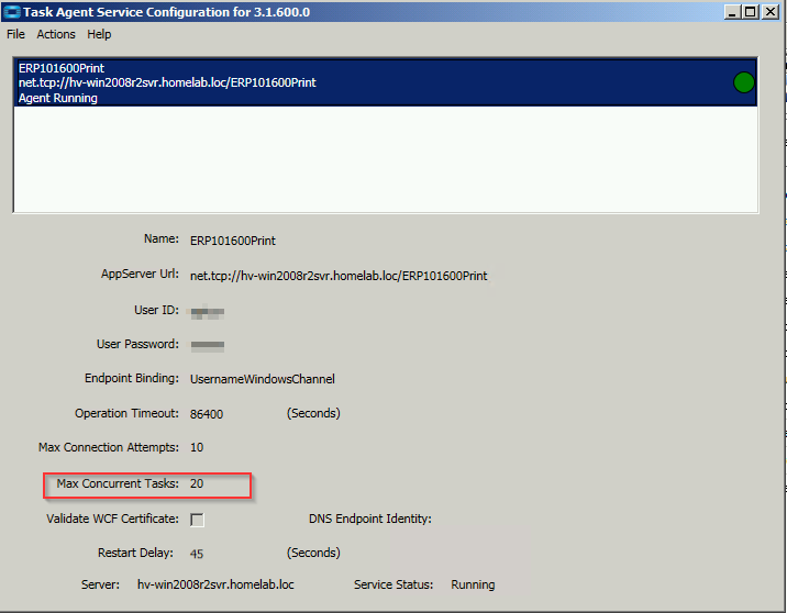

- Since we are talking about IMMEDIATE processing, every appserver process connected to the Epicor database must be configured for SSRS printing in the Epicor Administration Console, and the same web service URL, root folder, and report database name must be usedâif you have interactive and dedicated appservers already and have not configured SSRS against the interactive, that would need to be completed.
This is a screenshot of my dedicated background processing appserver > EAC> appserver Server Configuration > Application Server > Reporting Services tab. This is on a server named hv-win2008r2svr.
This is a screenshot of my interactive client appserver > EAC> appserver Server Configuration > Application Server > Reporting Services tab. This is on a server named hv-win2016svr. They are pointing to the same web service URL, root folder, and report database name. Good!

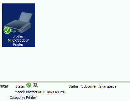

~INSTALL BROTHER MFC-7860DW printer on HV-WIN2008R2SVR WHEN LOGGED IN AS HOMELAB\SERVICE-ACCOUNT.
- I am going to make another assumption that people are familiar with this activity and not document it. Every printer is a little different.
~SHARE PRINTER ON HV-WIN2008R2SVR SERVER:
- Click the Windows button, and search for Devices and Printers.
- Right-click on the printer that was installed, and select Printer properties.
NOTE: I already had these screenshots from a Windows 2016 server, so if you are using Windows 2008R2 it will look a little different.
- Click on Sharing tab.
a. Check the box for Share this Printer.
b. Share name: Something meaningful without spaces in the name.
c. Render print jobs on client computers should be enabled as a general best practice in a LAN environment, but it can decrease performance in a WAN environment. You may need to experiment for the best configuration for your usage.
d. click Apply then OK.

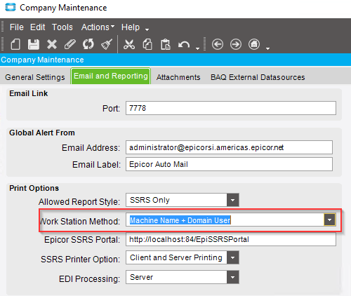

~CONFIGURE COMPANY MAINTENANCE RECORD TO ALLOW FOR BOTH CLIENT AND SERVER-SIDE PRINTING.
- While logged in with a security manager account, navigate to System Setup > Company / Site Maintenance > Company Maintenance.
- Click on Email and Reporting tab.
- In the Print Options section, in the SSRS Printer Option dropdown, select Client and Server Printing if it is not already.
- Save your changes.
