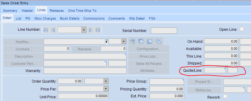

I believe that you can go into the Sales Order LINE and enter the quote number on the line to link them after the fact.
You should be able to add that quote information here:
So, would you enter the quote number as a Part?
The Quote/Line is grayed out and will not let me enter the quote number:(
