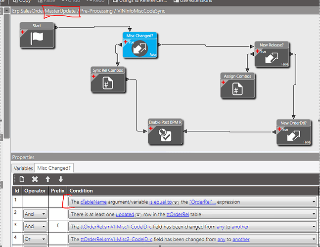

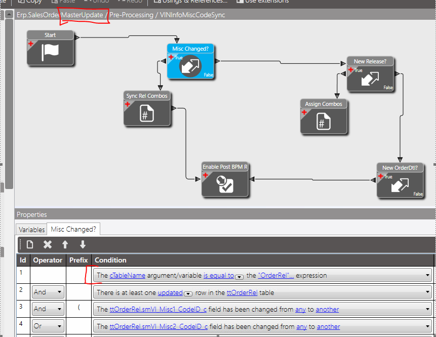

This would trigger it on all tables being updated… you could do a wrapper around it and do
// im going to assume I got the table names right
if (cTableName == "InvcMisc" || cTableName == "InvcHead" || cTableName == "InvcDtl")

I hope that works… Sometimes I even check for changes in the PRE and then Enable a POST

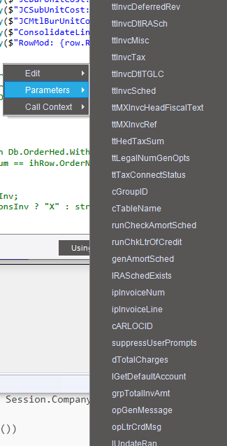

Always check for available parameters via the context menu… :slight_smile: they help alot.

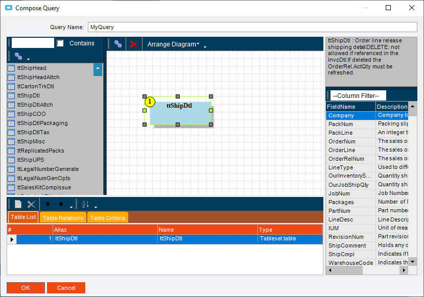

set what you want from the tttable as a parameter then use it in your condition in the original database table not the tt one
What do you mean?
replace the ttShipDtl by the Database ShipDtl
Got ya :smiley:

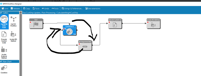

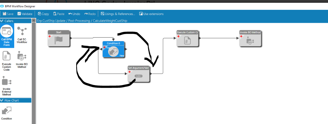

You would have to do a trace… Perhaps GetShipments doesn’t invoke the Update or UpdateMaster (im assuming your creating invoices via GetShipments). I bet if you go to the Invoice add a new Misc Charge and save, it would trigger.

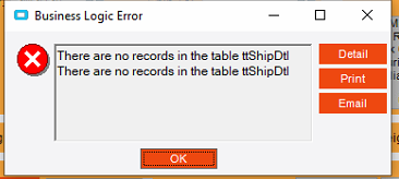

Still giving me this…

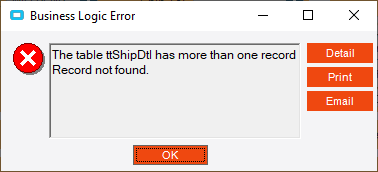

This error is thrown up when they click Mass Shipment on Customer Shipment Entry - Off-topic of the current thread but similar problem.

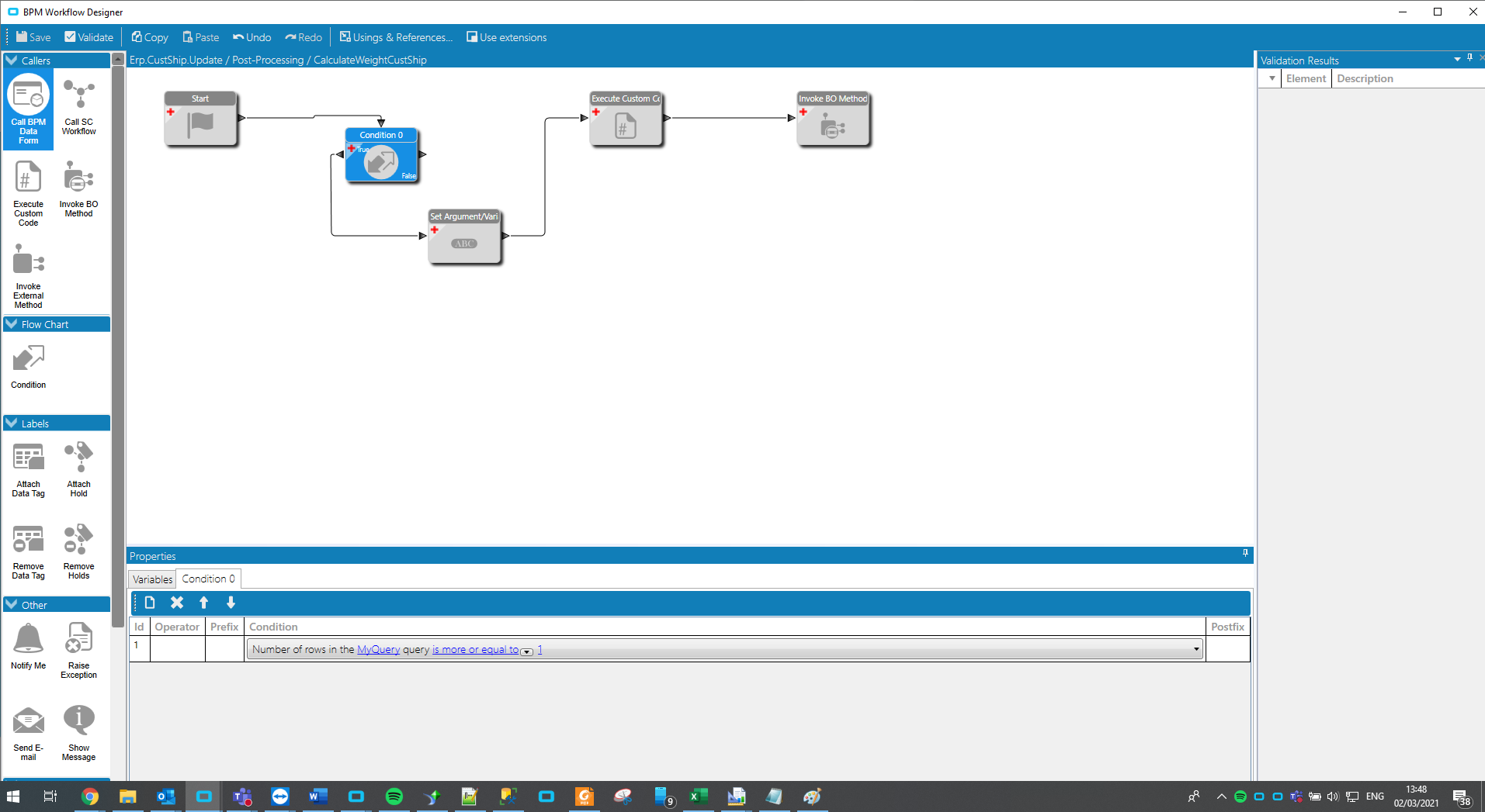

i think that you need to set the parameter first then use it in the condition widget , is not it ?
Some directives fire just once per call, even though the widgets are still there to allow you to structure the logic as though it’s firing for every record. When you get that combined situation, you get the “more than one record” error, because you’re asking it to do something to one row and it has several to choose from.
Usually, you either have to find a different trigger with the same records, or fall back on custom code and loop through the records in it.
