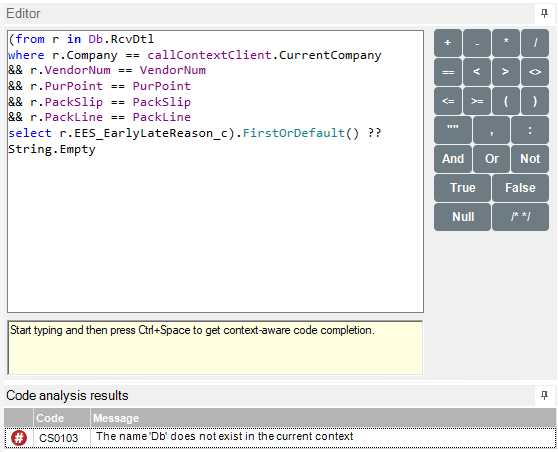

I’m trying to write a LINQ query to set a variable in a widget in a function. I can’t use Db.TableName. Is there a way I can do this or do I need to change to a custom code function and create a context, etc.?
Add RcvDtl to Tables
I wish it were that simple. I’ve got the table in there.
Did you set db access on the library page?
This is how I have it setup.
Add your function here.. Obviously blank out any intellectual property.
CustomizationHelpers.efxb (15.2 KB)
There’s not much to it. It’s the only function in the library and I only added one widget (which is the Set Variable widget I took a screenshot of).
Maybe I have something setup incorrectly. I knew of the two things you guys have suggested. But I am unaware of anything else.
Thanks!
Looks like Db is only allowed for widgets with code function type, not just for widgets.
If i create Widgets with Code function, i can verify that expression
OK - I can run with that. Thank you very much!! Didn’t even think of that.
