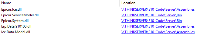

Let me show you via screenshots:
F4:
web.config location
ErpContext in web.config or even IceContext dont use local

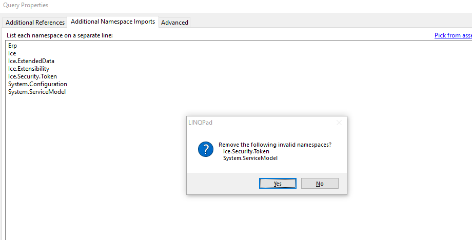

One thing I did notice is that when you do a cleanup in the Additional Namespace Imports it asks to remove the Ice.Security.Token and System.ServiceModel namespaces.

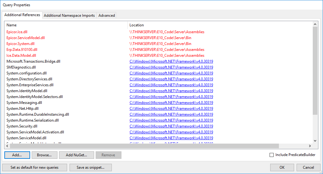

I get the same for the Security Token but not the ServiceModel… grab the Haso_Shipping one instead or make sure your Dependencies are not Red I know in E10.1 they moved some of the dlls to he Bin Folder. Look at my last screenshot above, yours should look like this:
Just rechecked and I a now down to the security one. I have it working on my client also…Embarrassingly, I have the language set to c# Expression.

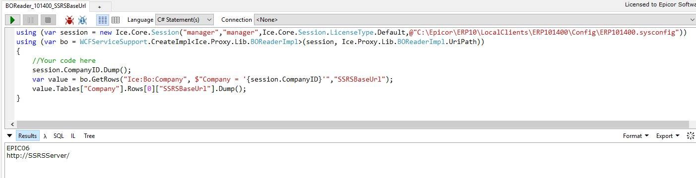

Adding this Screenshot to Convo #BOReader Example
