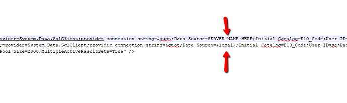

Make sure your web.config is accessible which you reference in the .linq file and make sure your web.config is not pointing to the DB Server “localhost” if your hosting SQL and AppServer on same Server then you have to change it in the web.config to the actual server name like MY-WINDOWS-SERVER and it should work.
No need to any connections or anything. It will use the ErpContext.
Benefit of using this instead of the LINQ Connection is that you can use Business Objects!
What Error make sure your web.config does not point to localhost it wont work because LINQ will try to connect to DB Server localhost aka your own computer and fail.
793b206d7e0b9a86e4f4afd29d5f160e4b3e6518_1_690x205
Change from (local) to SERVERNAME

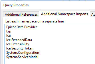

I finally found the missing pieces to make 10.2 to work.
Add references EntityFramework.dll and EntityFramework.SqlServer.dll
Add Namespace “Epicor.Data.Provider”
Call EpiProviderRegistrator.Register() after the InitialiseConfiguration(webConfigFile).
