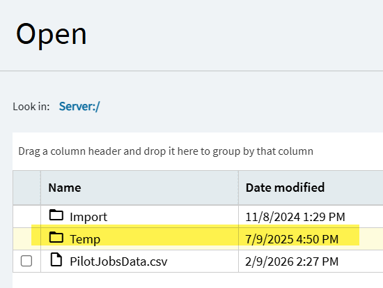

Does the folder exist?
For my testing I was trying to write into the Temp folder under the User in Server File Download. But for real location the Bartender folders also exist; One for Pilot and Prod.
The answer posted by @klincecum and others is correct. Switch your code to using ServerFolder.FileShare and that should write to your FTP share. If that is not working for you, please share the relevant code snippet and we’ll figure it out.
Yeah, I tried using that and it ran but the file was nowhere to be found. Perhaps I should tell Support the shared folder isn’t setup for us or is going somewhere we don’t have access too see? It’s not going to the FTP site like we need it.
I’m working directly with support on this. Please share the relevant code snippet where you are writing the file.
Thanks! :tada:
This works to get into subfolders. Now to get the FileShare setup or access too it if we can’t go FTP anymore.
DM’d you the code I’ve tried.

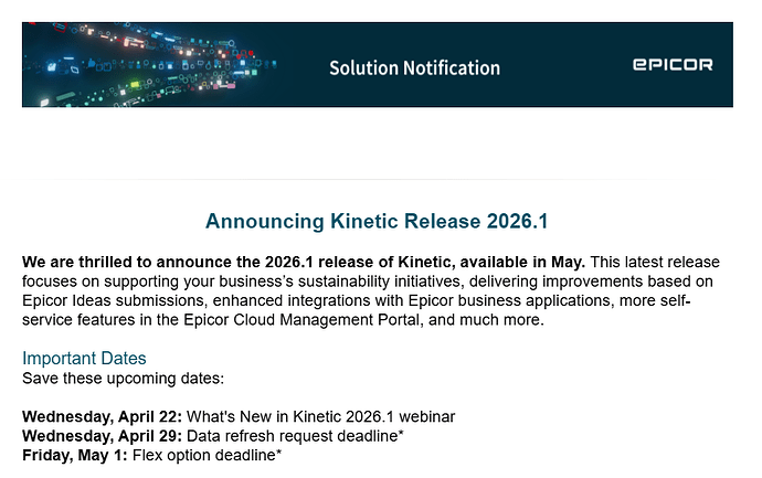

And with all the chaos going on with the Linux disaster…I just got this email.
“It never rains but it pours” comes to mind.
"We are thrilled to announce the 2026.1 your demise.. "
They sent on-prem customers the same email :melting_face:
