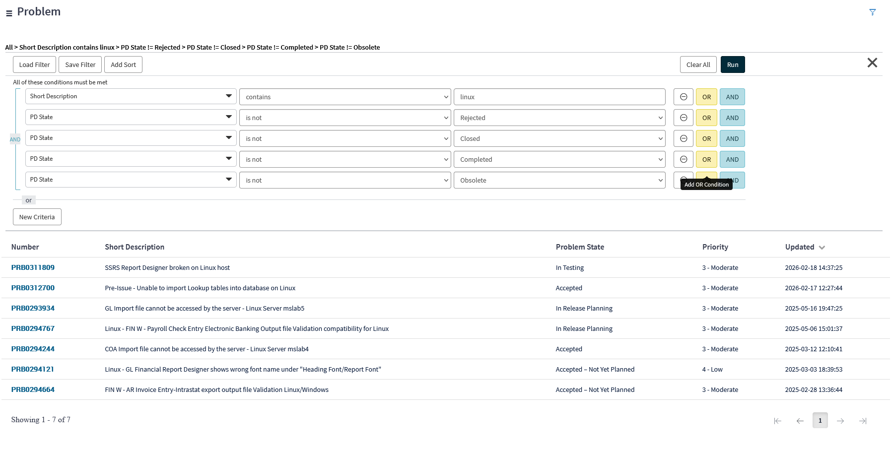

Related PRBS from @Evan_Purdy
PRB # Description State Priority
PRB0311809 SSRS Report Designer broken on Linux host In Testing 3 - Moderate
PRB0312700 Pre-Issue - Unable to import Lookup tables into database on Linux Accepted 3 - Moderate
PRB0293934 GL Import file cannot be accessed by the server - Linux Server In Release Planning 3 - Moderate
PRB0294767 Linux - FIN W - Payroll Check Entry Electronic Banking Output file Validation compatibility for Linux In Release Planning 3 - Moderate
PRB0294244 COA Import file cannot be accessed by the server - Linux Server Accepted 3 - Moderate
PRB0294121 Linux - GL Financial Report Designer shows wrong font name under “Heading Font/Report Font” Accepted - Not Yet Planned 4 - Low
PRB0294664 FIN W - AR Invoice Entry - Intrastat export output file Validation Linux/Windows Accepted - Not Yet Planned 3 - Moderate
