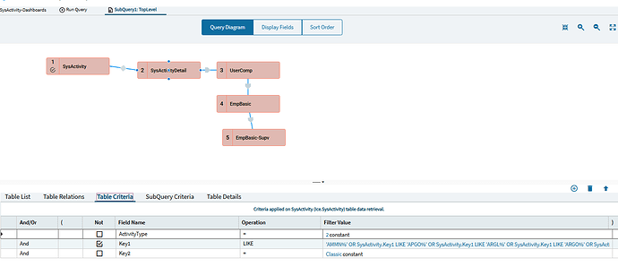

I created a BAQ to show me who was opening the classic screens… Then, to help with the Kinetic dashboard conversions, I filtered out the Epicor menu links (so it’ll just show our dashboards). Used Excel to do the bulk of the exclude expression.
Here it is, if anyone can use it and save some time:
select
	[SysActivity].[Company] as [SysActivity_Company],
	[SysActivity].[Key1] as [SysActivity_Key1],
	[SysActivity].[Description] as [SysActivity_Description],
	[SysActivity].[Key2] as [SysActivity_Key2],
	[SysActivity].[ActivityCount] as [SysActivity_ActivityCount],
	[SysActivity].[CreatedOn] as [SysActivity_CreatedOn],
	[SysActivityDetail].[UserID] as [SysActivityDetail_UserID],
	[SysActivity].[Key9] as [SysActivity_Key9],
	[UserComp].[Name] as [UserComp_Name],
	[UserComp].[EmpID] as [UserComp_EmpID],
	[EmpBasic].[JCDept] as [EmpBasic_JCDept],
	[EmpBasic-Supv].[Name] as [EmpBasic-Supv_Name],
	[EmpBasic].[ResourceGrpID] as [EmpBasic_ResourceGrpID],
	[EmpBasic].[ResourceID] as [EmpBasic_ResourceID]
from Ice.SysActivity as [SysActivity]
inner join Ice.SysActivityDetail as [SysActivityDetail] on
	  SysActivity.ActivitySeq = SysActivityDetail.ActivitySeq
left outer join Erp.UserComp as [UserComp] on
	  SysActivityDetail.Company = UserComp.Company
	and  SysActivityDetail.UserID = UserComp.DcdUserID
left outer join Erp.EmpBasic as [EmpBasic] on
	  UserComp.Company = EmpBasic.Company
	and  UserComp.EmpID = EmpBasic.EmpID
left outer join Erp.EmpBasic as [EmpBasic-Supv] on
	  EmpBasic.Company = EmpBasic-Supv.Company
	and  EmpBasic.SupervisorID = EmpBasic-Supv.EmpID
where (SysActivity.ActivityType = 2
and not SysActivity.Key1 LIKE 'AMMN%'
OR SysActivity.Key1 LIKE 'APGO%'
OR SysActivity.Key1 LIKE 'ARGL%'
OR SysActivity.Key1 LIKE 'ARGO%'
OR SysActivity.Key1 LIKE 'ARMT%'
OR SysActivity.Key1 LIKE 'ARRP%'
OR SysActivity.Key1 LIKE 'BMGO%'
OR SysActivity.Key1 LIKE 'CRGO%'
OR SysActivity.Key1 LIKE 'CRMG%'
OR SysActivity.Key1 LIKE 'CRMN%'
OR SysActivity.Key1 LIKE 'CRMT%'
OR SysActivity.Key1 LIKE 'DEGO%'
OR SysActivity.Key1 LIKE 'EQMT%'
OR SysActivity.Key1 LIKE 'ESGO%'
OR SysActivity.Key1 LIKE 'GLGO%'
OR SysActivity.Key1 LIKE 'ESRP%'
OR SysActivity.Key1 LIKE 'HHMN%'
OR SysActivity.Key1 LIKE 'IMGO%'
OR SysActivity.Key1 LIKE 'IMMT%'
OR SysActivity.Key1 LIKE 'IMRP%'
OR SysActivity.Key1 LIKE 'JCGO%'
OR SysActivity.Key1 LIKE 'JCMN%'
OR SysActivity.Key1 LIKE 'JCRP%'
OR SysActivity.Key1 LIKE 'MRGO%'
OR SysActivity.Key1 LIKE 'MRMT%'
OR SysActivity.Key1 LIKE 'OMGO%'
OR SysActivity.Key1 LIKE 'OMMT%'
OR SysActivity.Key1 LIKE 'OMRP%'
OR SysActivity.Key1 LIKE 'PCMN%'
OR SysActivity.Key1 LIKE 'PMGO%'
OR SysActivity.Key1 LIKE 'PMMT%'
OR SysActivity.Key1 LIKE 'PR00%'
OR SysActivity.Key1 LIKE 'QAGO%'
OR SysActivity.Key1 LIKE 'QARP%'
OR SysActivity.Key1 LIKE 'RQGO%'
OR SysActivity.Key1 LIKE 'SEGO%'
OR SysActivity.Key1 LIKE 'SEMN%'
OR SysActivity.Key1 LIKE 'SRGO%'
OR SysActivity.Key1 LIKE 'SRRP%'
OR SysActivity.Key1 LIKE 'SUMN%'
OR SysActivity.Key1 LIKE 'SUMT%'
OR SysActivity.Key1 LIKE 'SVGO%'
OR SysActivity.Key1 LIKE 'SVTK%'
OR SysActivity.Key1 LIKE 'XAMN%'
OR SysActivity.Key1 LIKE 'XAPR%'
OR SysActivity.Key1 LIKE 'XAMe%'
OR SysActivity.Key1 LIKE 'XAGO%'
OR SysActivity.Key1 LIKE 'XABA%'
OR SysActivity.Key1 LIKE 'BPMN%'
OR SysActivity.Key1 LIKE 'HDMN%'
OR SysActivity.Key1 LIKE 'GLMT%'
OR SysActivity.Key1 LIKE 'HDGO%'
OR SysActivity.Key1 LIKE 'JCMT%'
OR SysActivity.Key1 LIKE 'OTOC%'
OR SysActivity.Key1 LIKE 'PMPR%'
OR SysActivity.Key1 LIKE 'PRAR%'
OR SysActivity.Key1 LIKE 'PRSR%'
OR SysActivity.Key1 LIKE 'PROM%'
OR SysActivity.Key1 LIKE 'PSMN%'
OR SysActivity.Key1 LIKE 'SRPR%'
OR SysActivity.Key1 LIKE 'SUUT%'
OR SysActivity.Key1 LIKE 'UD100000'
and SysActivity.Key2 = 'Classic')
group by
	[SysActivity].[Company],
	[SysActivity].[Key1],
	[SysActivity].[Description],
	[SysActivity].[Key2],
	[SysActivity].[ActivityCount],
	[SysActivity].[CreatedOn],
	[SysActivityDetail].[UserID],
	[SysActivity].[Key9],
	[UserComp].[Name],
	[UserComp].[EmpID],
	[EmpBasic].[JCDept],
	[EmpBasic-Supv].[Name],
	[EmpBasic].[ResourceGrpID],
order by SysActivity.Key1, SysActivity.CreatedOn, EmpBasic-Supv.Name, SysActivityDetail.UserID
