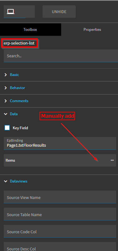

A little back story. There is an issue with the configurator designer and custom views. You can create custom views but they will not save. I have a ticket into Epicor and they have acknowledged the issue and are working on it. Not sure how long this will take. In the mean time I am trying to find work arounds. In application studio I can load items into a “erp-selection-list” using a “rest-erp” widget but because of this dataview issue this method does not work. I can use the “Items” section below the “epBinding” area in the “Data” section to add them manually but I have a lot of items to add. Does anyone have a work around?
