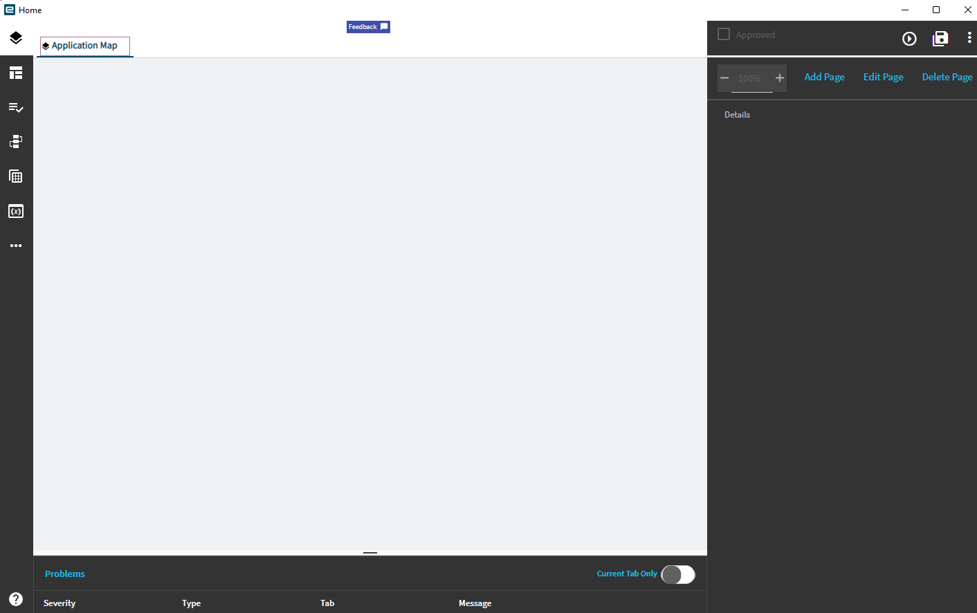

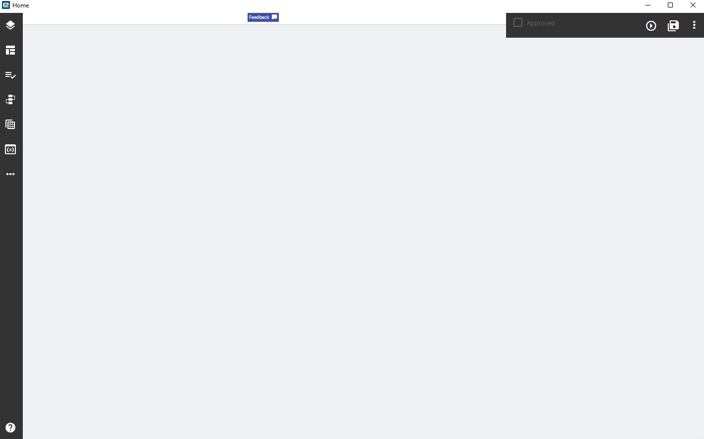

This is Epicor Kinetic. I was working in configurator designer, and was getting an error message when I tried to save in the configurator designer. It was a slide out panel Error message with no description. Tried to track it down and could not find the source so I decided to try closing and reopening configurator designer entirely. When I went back into configurator designer I see nothing in the application map. I see no layers in the top right.

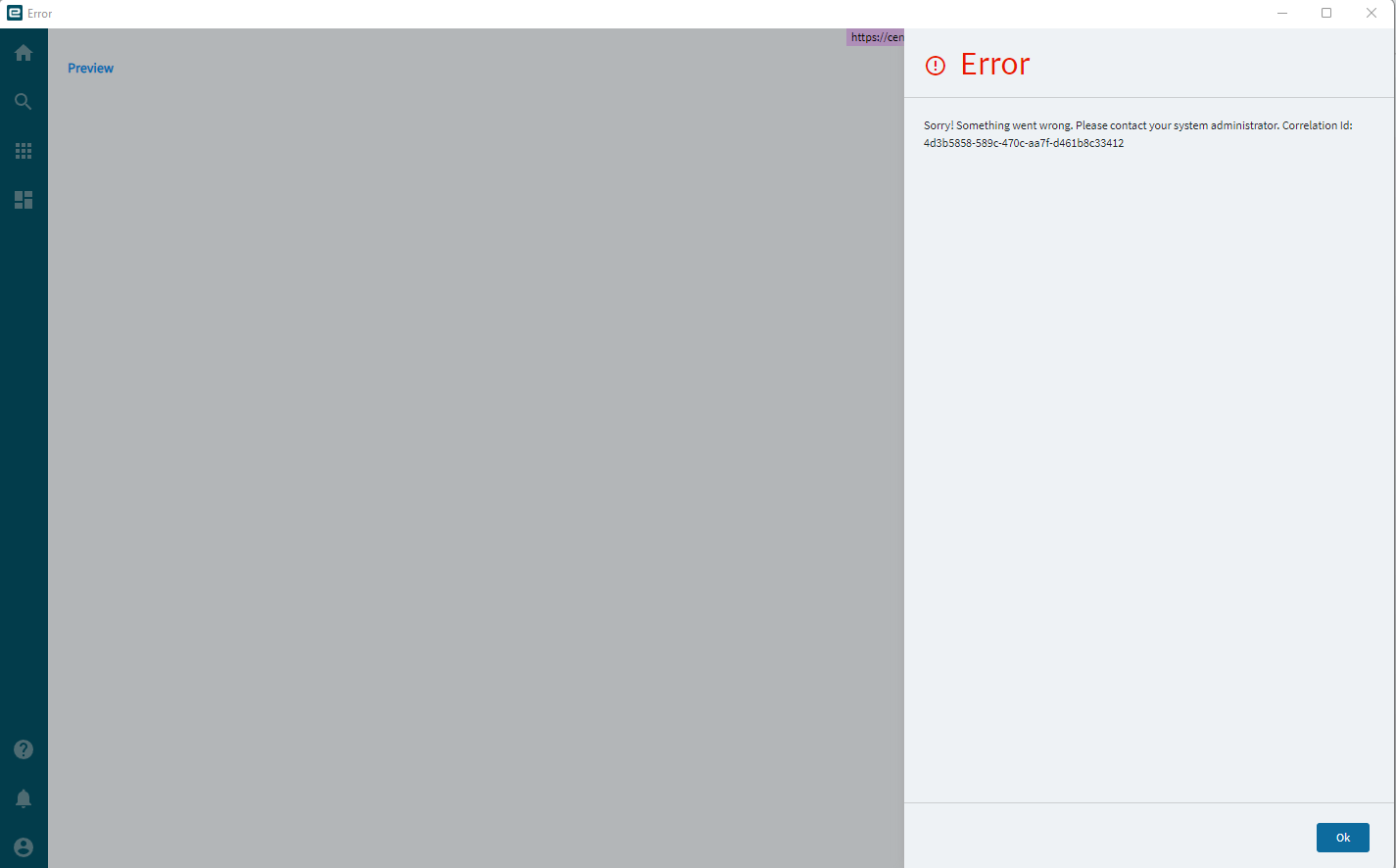

It is like this for all users, on smart client or on browser. I am also attaching a screenshot of the error when I try to preview the configurator.

In dev tools I am seeing a 500 error on the GetApp function that runs on the designer page when you first open it through browser. I am not seeing this on other configurators. I am not familiar enough with Epicors form loading to know exactly what could be causing this. Will update this page if support has any useful information for me.
