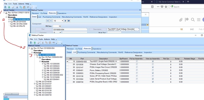

I did try for one part. Its running for hours without results. I think part of the problem is that each layer of subassembly has multiple revisions and the query is cross referencing too much.
For example…
Top level has 3 revisions. Rev 1, 2, 3
1 layer deep, 4 parts, each part is a sub-assembly with multiple revisions, Rev 1, 2, 3 for each.
How does the query know that Top Level Rev 3 uses Rev 3 for the sub-assembly part? I don’t see anything in the Method Tracker or in the table that tracks which revision of the sub-assembly should be followed. Does Epicor just assume to use the most recently approved revision? I think the query is trying to build a BOM that includes each revision of the sub assembly.
correct Epicor doesn’t track the rev of the child part.
