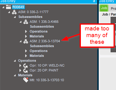

I’ve never split a job before, but at first glance, it looks like it just takes some quantity of the top level part number (the job header number) all sub-assemblies are made on this job and it’s one of those that have too many, not the final job part number. For that to work, I would have to increase everything else to match, and I don’t want to do that.
It would make sense if we did a job for each sub assembly, but we don’t run jobs that way here. Good idea though.

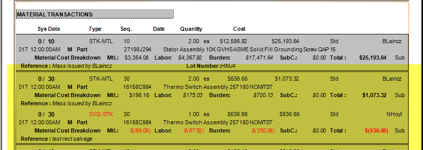

Have you considered job salvage to stock? I tested one here and this is what prod detail looks like for the matl transactions. We use this to pull stuff off jobs and place in inventory plenty.

Close, but it’s an assembly not a material (I was excited when I looked because I thought it would work)
No, because it’s not the final part, it’s a subassembly that has too many. Here’s an example.

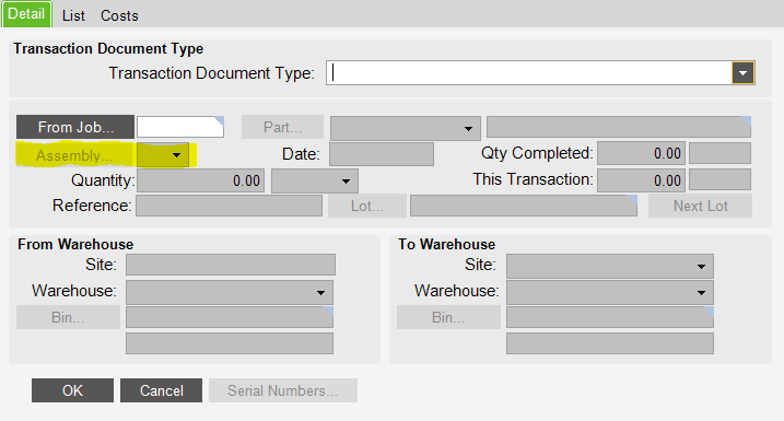

As long as your subassemblies can go to stock, just use receive job to inventory and select the subassembly.
Regardless of the demand link, you should be able to process a job receipt
to inventory for the extra items…Just be sure you remember to consume
them if the item is generally managed as non-stock.

I would have liked to see the costs transfer from Job to Inventory. Very disappointing that sub-assemblies are not able to be received to inventory and transfer the cost from job to inventory at the same time.

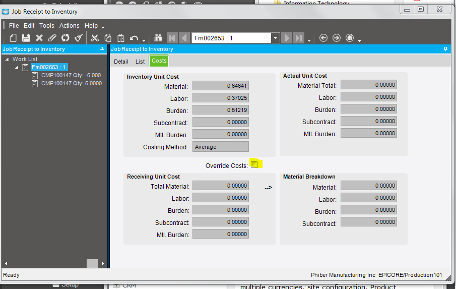

I looked closer and in my version 10.1.400 I went to the Costs tab in Job Receipt to Inventory, hit override and grab the values from job closing for the cost. Click ok on the detail page after selecting the qty and the warehouse location.

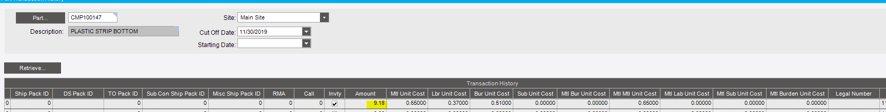

Check part transaction history for a part cost. The costs show in Inventory WIP as well, just make debits and credits balance. I believe this process should make a subassembly receipt to inventory a simpler sequence.
