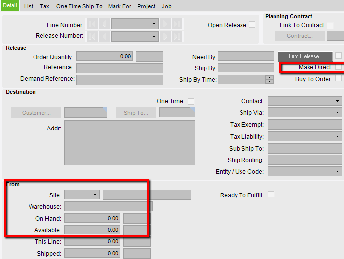

I agree with @Nancy_Hoyt that there is no system that will do this. What you could do is to make sure you have a process in place where sales order entry people are checking the releases to see if there is inventory available. If there is inventory, they can un-check the make direct box.
Also, you could introduce a BPM that verifies the inventory and pops up an info screen to let the user know that there is inventory.

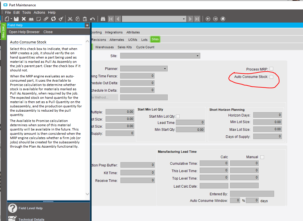

I haven’t used this feature, but wouldn’t flagging Auto Consume Stock in the part master help for this?
That reads like it is for sub-assemblies and not finished goods.
