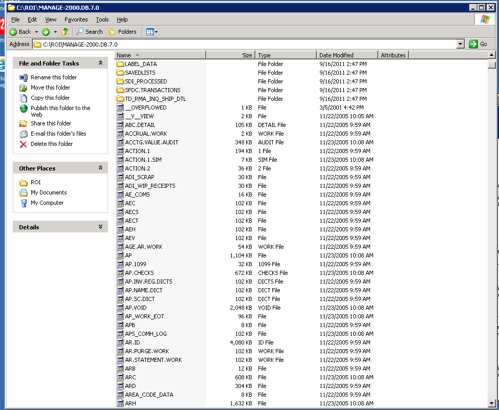

These are the kind of files I’m seeing in the directory.

what are the filetypes?
There’s a screenshot up above that shows the file types.
Things like *.MASTER and *.WORK.
found this from a Google search, not sure what it means…
“The Company’s Avanté and Manage 2000 products leverage open database technology from IBM Corporation.”
Looks like it uses IBM UniData. Now I just need to figure out how to query it.
