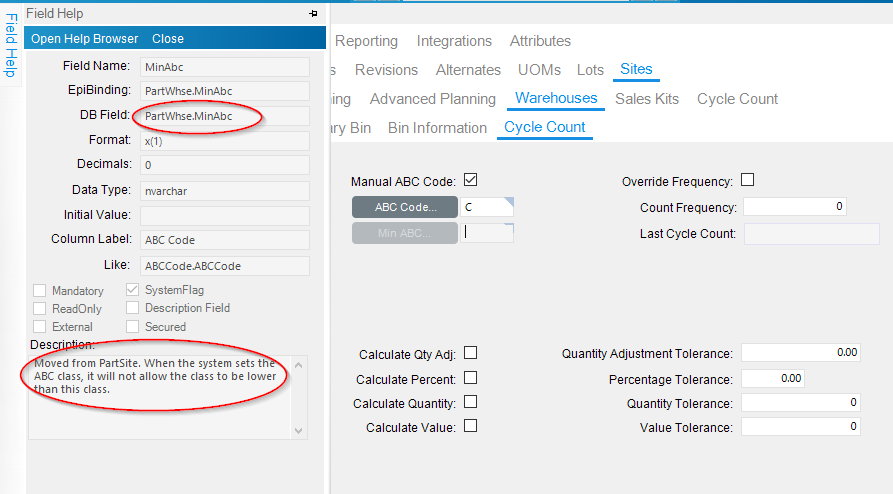

I believe that the fields you are looking for is PartWhse.MinABC (character) and PartWhse.ManualABC (bool)
@timshuwy Thanks so much!

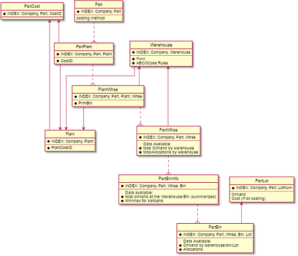

Any idea why the Part Warehouse DMT requires the Plant field or where this field comes from, as I don’t see it in PartWhse?
Write a BAQ to link PartWhse to PlantWhse to get Plant of that Warehouse.

Here is a simple diagram that I put together with plantuml (Interested in plantuml? I will make a special post). this shows a little more detail than you need for the ABC Code… also shows where to get costs, on hand, etc.
