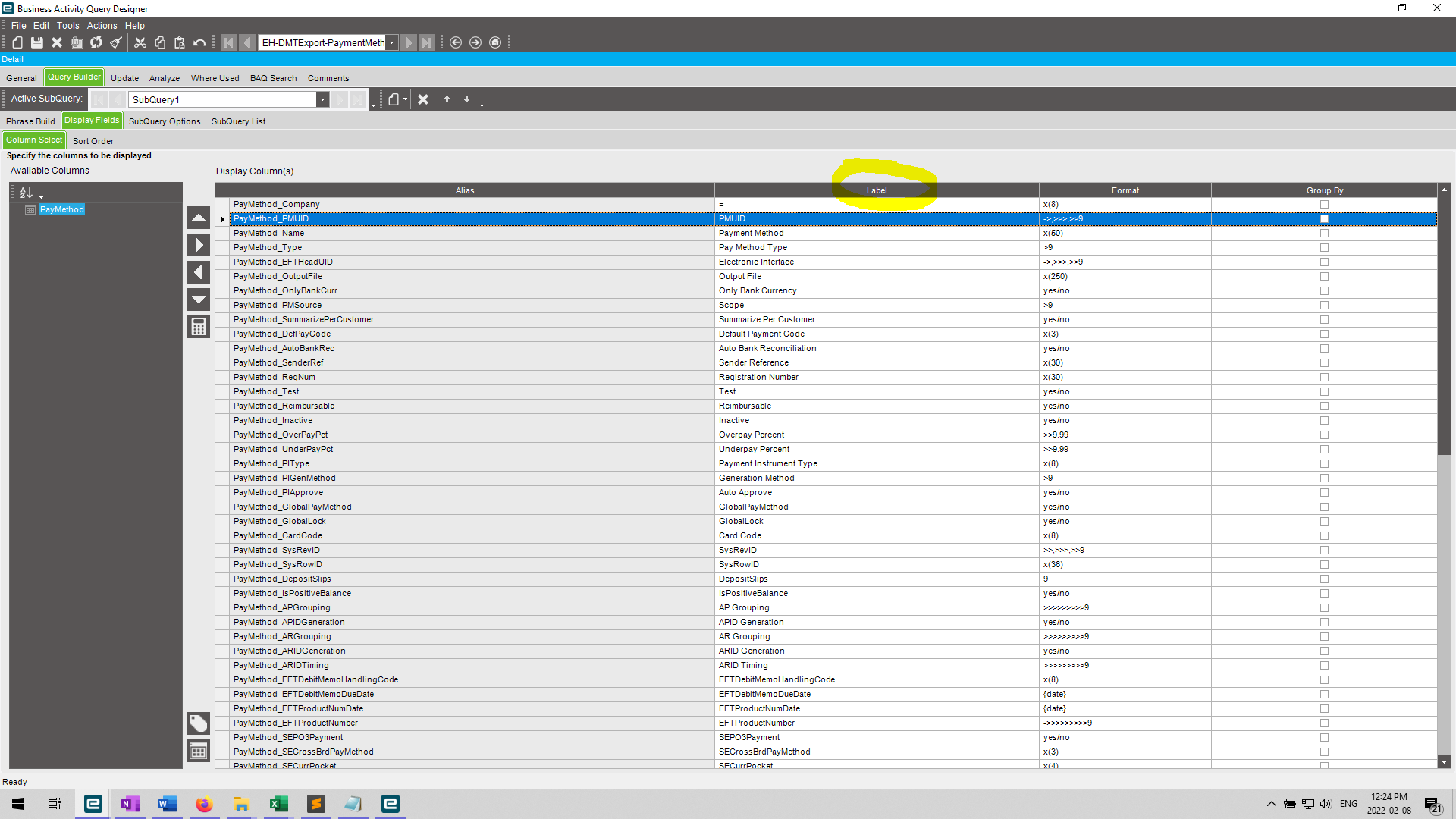

I’m having an issue figuring out how I can mass update the column labels in a BAQ so that they match with a DMT import. See below.
I’ve also written a batch file that exports these BAQ’s and will eventually put them in a playlist so that I can quickly sync between testing/pilot databases and Live. To keep this automated, I need the exported BAQ labels to match what’s required by the DMT.
I have lots of BAQ’s to do this with, so I would like to stay away from manually updating the column labels as much as possible. I have tried editing the BAQ source files through archived xml files, however this seems to have the similar outcome of having to manually update the column labels.

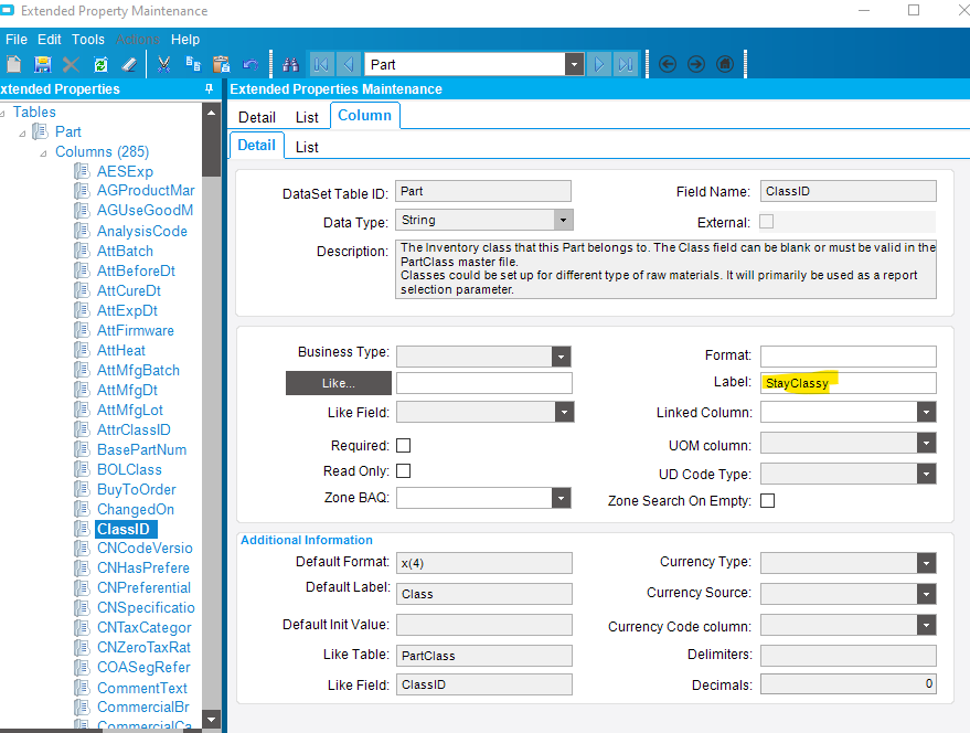

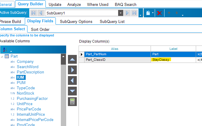

Another approach might be to update the Extended Properties for the columns you’re trying to rename. That seems to work.
Works like a charm! Thanks for the help.

The dashboard columns will stay named whatever they came into the dashboard with when it was created. You can manually re-name the labels in the dashboard and it will copy in the BAQ’s labels over the existing dashboard labels. But that doesn’t happen unless you ask it to.
I don’t believe it will update BAQs automatically but I’m not 100% sure. I feel like existing BAQ fields are records in a table somewhere and the label is a column in that row. Anything existing, like a dashboard, should stay the same. But any new BAQ field will come in with the new label from Extended Properties. Again, I’m not 100% that’s true but that’s my hypothesis.
