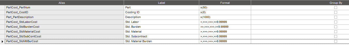

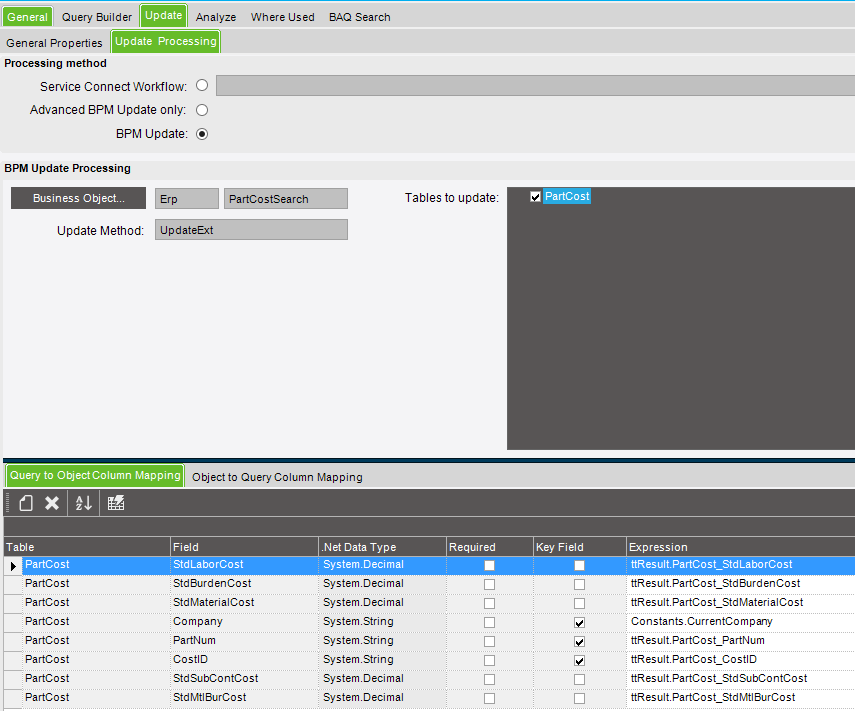

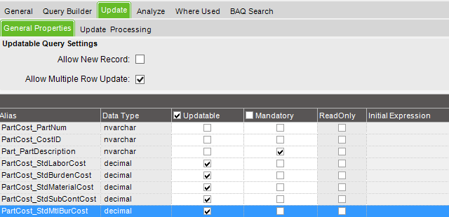

I have created an updateable BAQ which updates the value of the standard cost, but does not perform the action of creating a cost adjustment within part tran, which I am told will screw up the general ledger.

A lot depends on exactly what you mean when you say, “screw up the general ledger”. If you use the Costing Workbench the Cost Adjustment program, or any updateable BAQ that affects the PartCost table, you will modify the standard cost on the parts involved, meaning if any of them are currently in inventory their value will change, which will have a GL effect. If all you want to do is change your price list, then do not use any of those processes.
