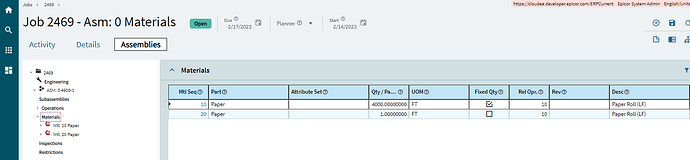

As a consultant, the way i would have specified this to be done would be to add your material two times to the BOM…
- first you would list the material consumed in the SETUP… you would specify the quantity, and mark the quantity as “Fixed Qty” so that it would not change based on the job quantity.
- second you would list the material again, but this would NOT be fixed quantity.
If you are BACKFLUSHING then these two materials would be assigned to the operation that consumes them. If you have a special operation that is for setting up the machine, then you could have the first fixed quantity material assigned to that setup step.
Thank you. I would never have thought of this but it makes perfect sense.
