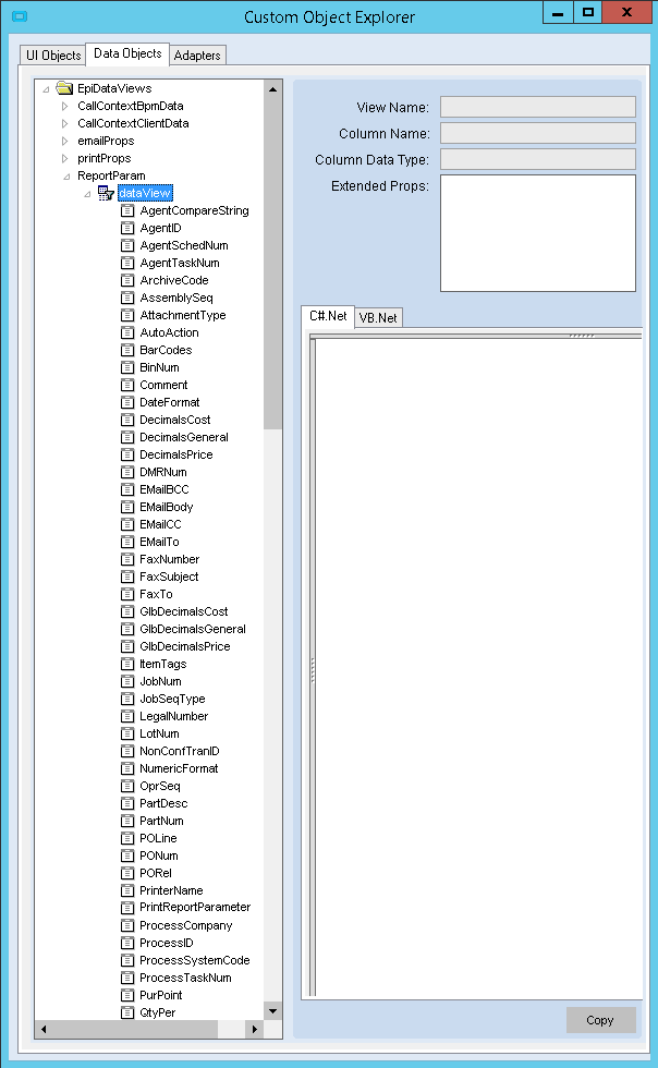

Okay. I am not quite sure how to go about decompiling the assemblies, but I do know how to run a trace, so I’ll give that a shot. Thank you.
I did manage to located the following MtlTagsParam in the trace log. The rows seem to parallel what was in the object explorer only in a different order. Should I modify the BuildMtlTagParams() to mirror the rows in the trace log and in the order found in the trace log?

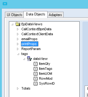

Also, in the trace log I found rows for the ItemTags dataset which I also saw in the Object Explorer. Do I need to reference this as well in the script?

I don’t think those parameters are right - looks like way too many. I think your best option is to decompile the assemblies.
