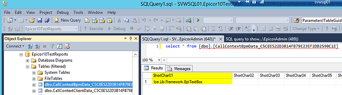

I am receiving no compiling error messages now and I have finally reached the point where the {CallContextBpmData.ShortChar01} field is being populated.

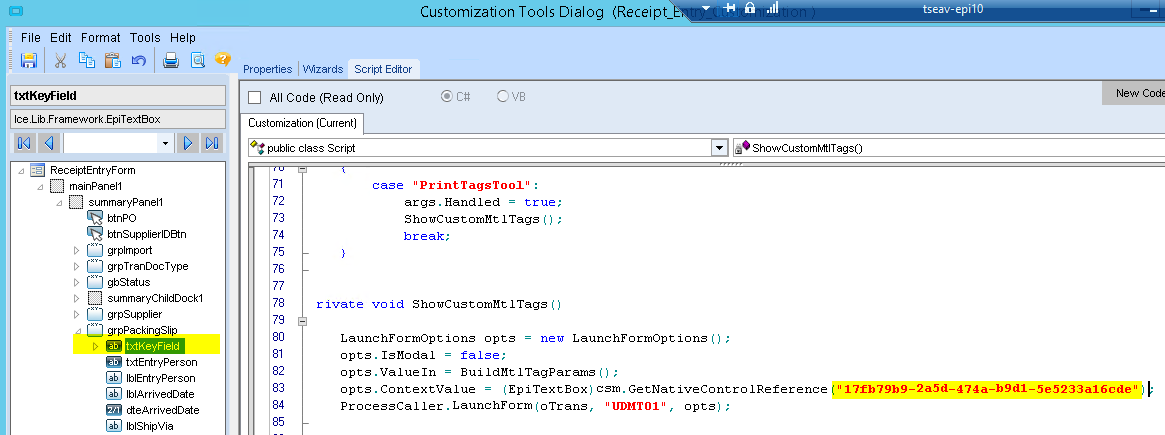

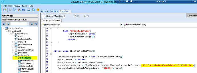

However, instead of inserting the actual Pack Slip number, it is inserting text that appears to be the name of an Assembly Reference. As you can see in the image below, I have used the native control reference for the txtKeyField (PackSlip). If I change it to opts.ContextValue = “txtKeyField”; then ‘txtKeyField’ is what populates in the {CallContextBpmData.ShortChar01} field. Any ideas?
Tanesh, can you clarify the syntax of the .Text property?
I have tried several configurations of it to set the opts.ContextValue in the ShowCustomMtlTags() but to no avail. Should I get the value of txtKeyField by using the GetNativeControlReference ID or is there a better way to acheive this?

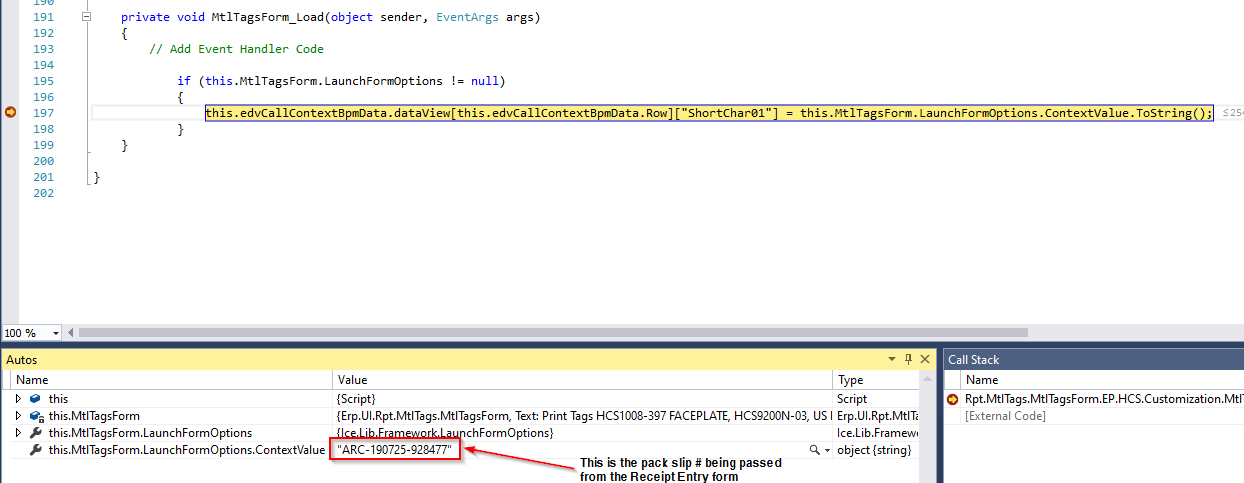

I would open up the receipt entry customization in a debugger and verify that it’s actually getting the packslip value when the LaunchFormOptions object is being built.

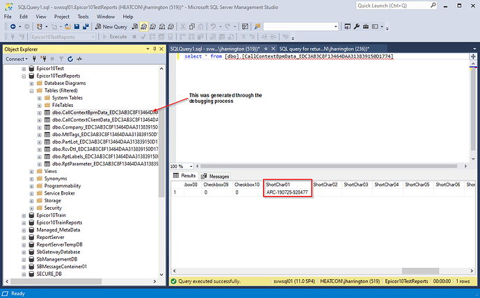

This is where I am at. I have managed to debug the Receipt Entry Customization and it is setting the ContextValue for the pack slip number and passing it to the Print Material Tags form. When I then ran debugging on the MtlTags customization, I could see that the pack slip number was there in the LaunchFormOptions; however, for some reason this line of code is not placing the pack slip number in to “ShortChar01” because when I run a SELECT statement in SQL on the callContextBpmData table, that column is blank. Any ideas?
I have an update to this. When I run the customization through the debugging process all the way to the end and generate the labels, I can see the pack slip number is populated in callContextBpmData.ShortChar01 in my SELECT statement. HOWEVER, when I generate the labels without debugging, it does not populate the pack slip number in to ShortChar01.
