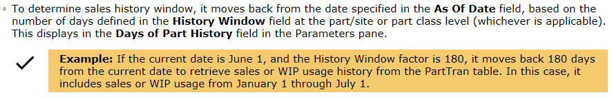

Hidden indeed I was unfamiliar with it, in the help it has “the As of Date field, select the cutoff date for usage history used to perform quantity calculations” this is the end date to be considered correct? is there a way to dictate the start date? our early years of transactions are inaccurate so I would like to only use the last 3 years
Hi Melinda,
Yes, the ‘As Of Date’ is the date it works back from. The number of days to look back from this date is set using the ‘History Window’ at either part class or part level.
From the Epicor Application Help:
