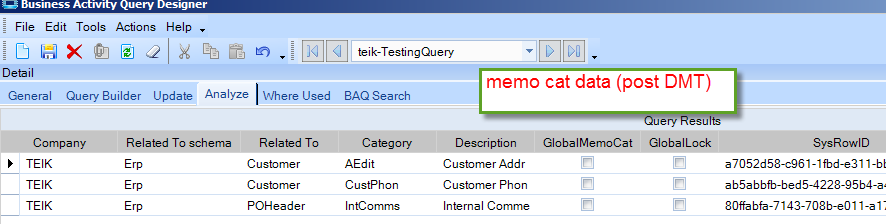

When I am planning to DMT I like to go and make a BAQ of the data that I plan to upload to, to see sample for the fields. Doing this for memo cat, I get screenshot 1. (We don’t use memo much). There is a table that has IDs that it needs to use (MemoCatRelatedToTable) screenshot 2 of some of our data. I frankly have no idea how those records got in there, and think it odd that they’re in duplicate. I suspect it’s a system thing. Anyway, do all of your memo cat records to be DMT’d have data in RelatedToFile field that has association to RelatedToTableName records in MemoCatRelatedToTable?
I am able to DMT the following with no error in test:
