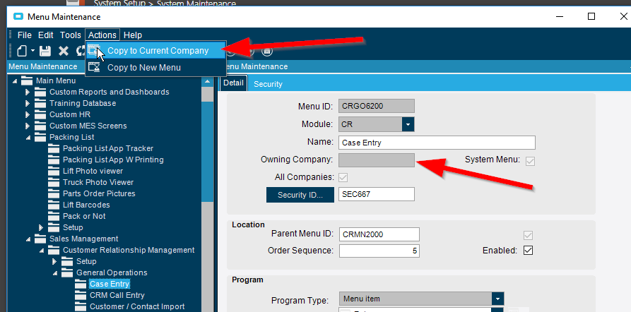

I had this the other day. Check that the company for the menu short cut matches the company for the customisation. If the short cut is for a specific company In menu maintenance you can go actions create for this company (or some thing like that) to create a new menu short cut for the current company. Hopefully the customisation shows up then.

You have to copy the menu item in menu maintenance so that it’s a company specific menu. Stock menu items are not company specific (even in single company settings). So if you use actions, copy to current company, your original customization will work.

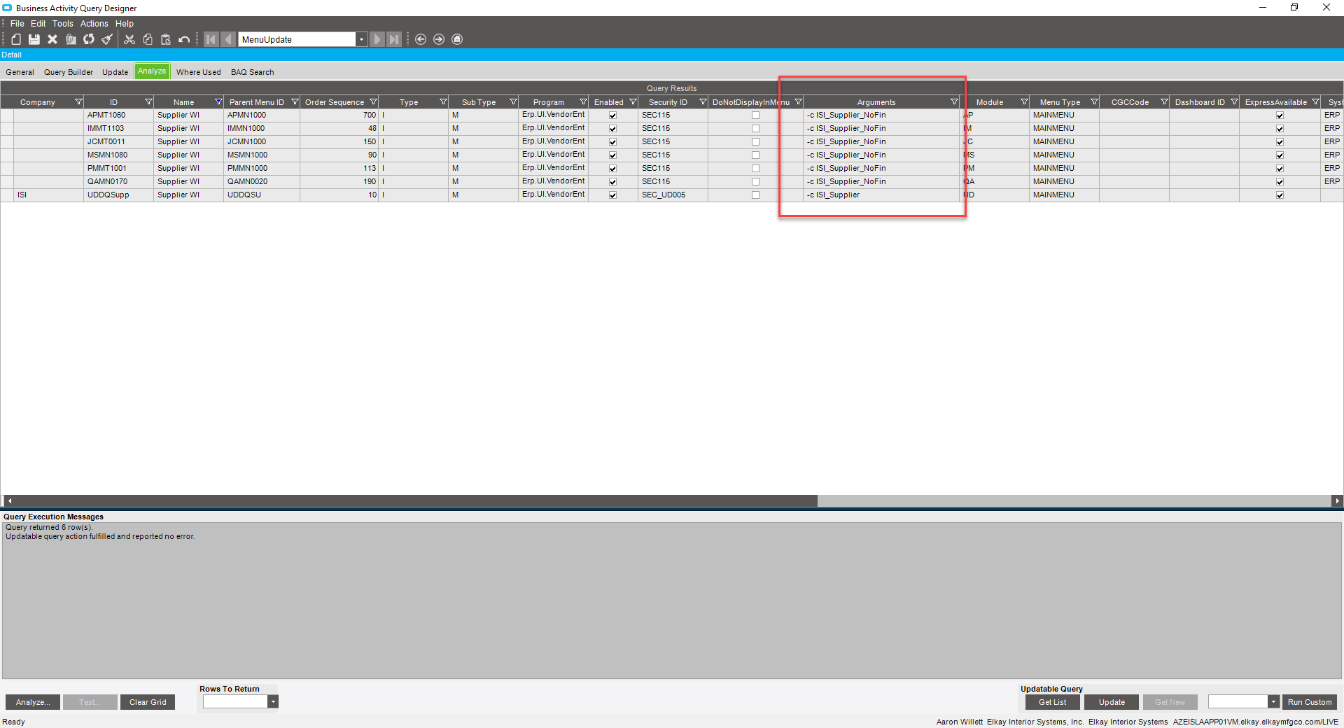

Just ran across this and the fix is no longer available, but support did give me a workaround.
I created an updateable BAQ to update the Arguments field on the Ice.Menu table.
You just add a “-c <CustomizationName>”. Worked like a charm!

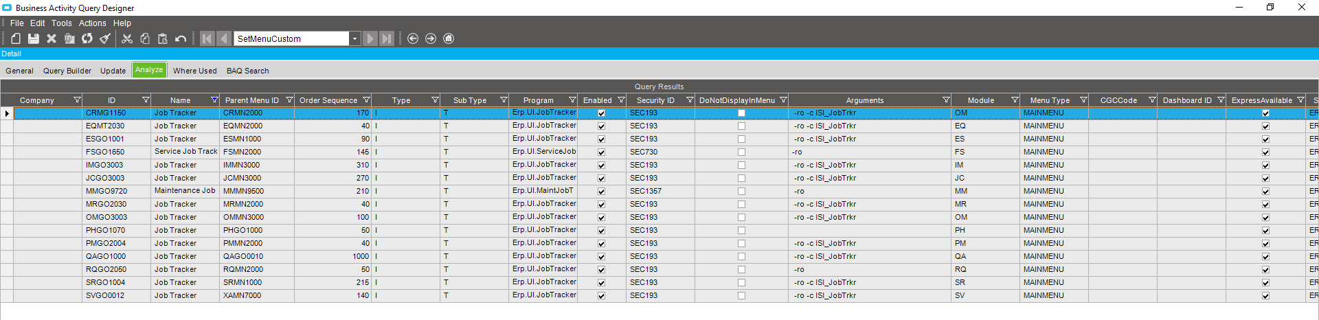

I am currently having this issue for Job Tracker. I have tried changing the customization and the menu to All Companies and specific to our company. Neither shows any customizations.
I have attempted to change the arguments in the Menu table and this will allow whatever I enter to show in the dropdown but the changes do not stick when exiting out and reopening and the arguments reset to ‘-ro’.

Add the customization to the end of the -ro. Trackers have the -ro to stay Read Only.
Here’s what I have for my Job Tracker:
Yes. I have exited and relaunched whenever I make a change. I have also been clearing the client cache.
