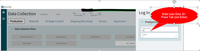

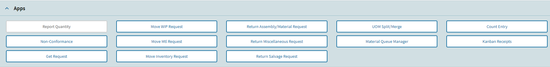

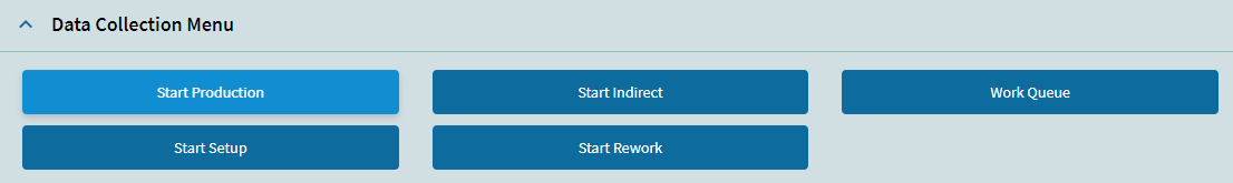

After logging into an Employee ID with the method that @dgross provided above, the blue buttons under Data Collection were working correctly again, but clicking any of the white buttons caused a separate issue. (Move WIP Request, UOM Split/Merge, Count Entry, etc.)
Working when using the login method that @dgross provided.
Clicking any of the white buttons STARTS to open the page as you’d expect, until the authentication breaks and you’re prompted to login again and are taken out of MES back to the main Kinetic “Home” screen.

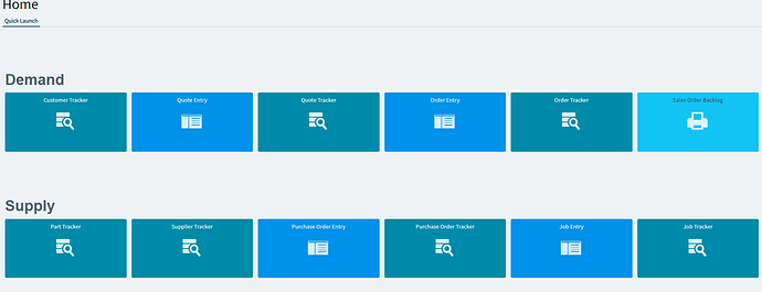

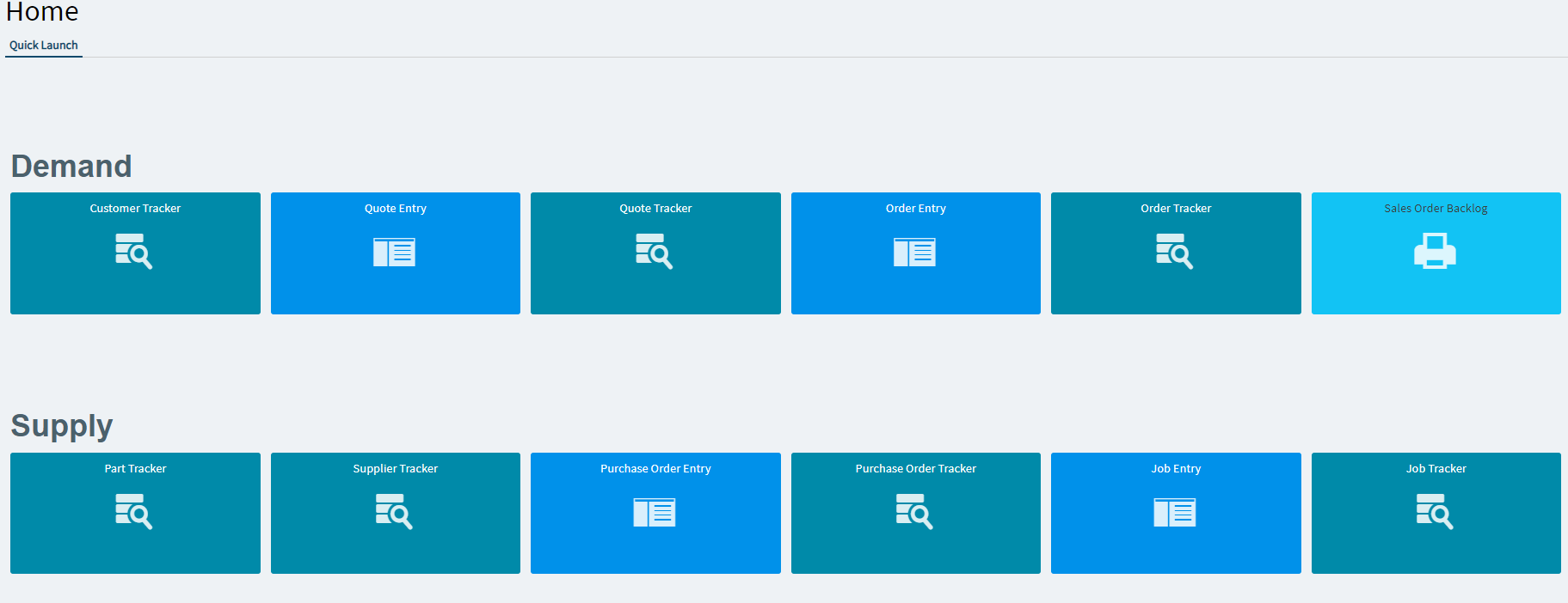

After logging back in, this is where you will end up. However, now none of the tiles on this screen are interactive and clicking them does not do anything.

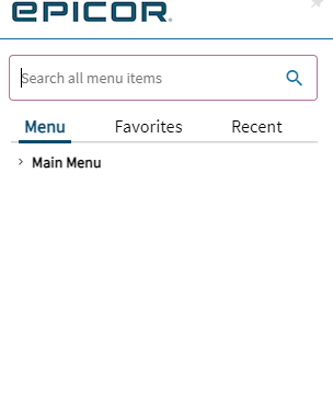

Opening the navigation pane will show a blank list with just the “Main Menu” dropdown present. There is nothing under this menu, and searching produces no results.
Refreshing the page does NOT correct the issue. The only resolution is to close the tab completely and log back into Kinetic/the MES again.

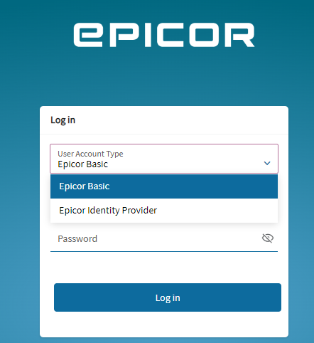

SOLUTION 1: Login to Kinetic with an Epicor Basic login rather than an IDP account.
This was the first solution we tried that caused both of the blue and white buttons to work correctly. There seems to be an issue with how IDP logins authenticate on mobile platforms in the MES, but Basic seemed to work just fine and never prompted for another login after clicking the white buttons.
1. When logging into Kinetic, click the drop down under “User Account Type” and change it to “Epicor Basic”. You will need to ensure that you have an account created in the Basic format in “User Account Security Maintenance” first We created a few of these to use on our tablets for our shop floor in place of IDP logins.

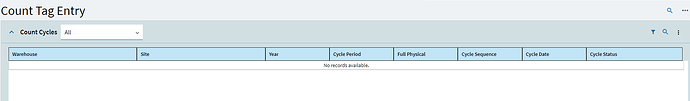

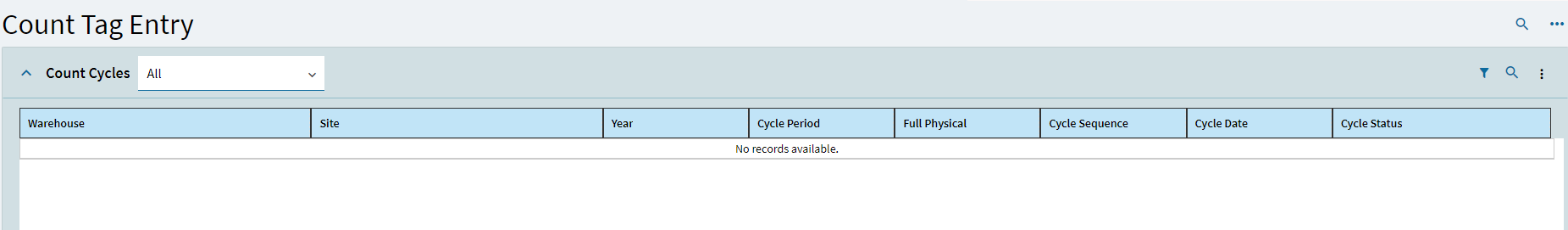

2. Log back into the MES with an Employee ID. Be sure to continue to use TAB and not the ENTER key when logging into the ID just in case. For this example I’m clicking the white “Count Entry” button to see if it will open correctly.
3. After clicking “Count Entry” the correct screen in Kinetic opens without any issues, and I’m not prompted to log back in.
