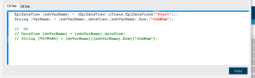

I think it should be like this, according to the Object Explorer.
EpiDataView CurrentView = ((EpiDataView)(oTrans.EpiDataViews[“Start”]));
string jobNum = CurrentView.dataView[CurrentView.Row][“JobNum”].ToString();
