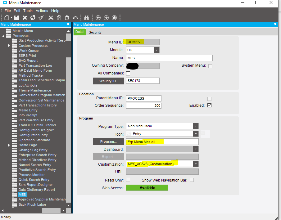

MES Main Menu Customization
You need to make a new menu item in menu maintenance for MES that has your customization with the added button, then reference that menuID in the sysconfig:
Open ConfigEditor.exe in epicor client folder:
This will just set the default customization MES opens with.
Okay this helped! i thought you made the menu item first before the customization,

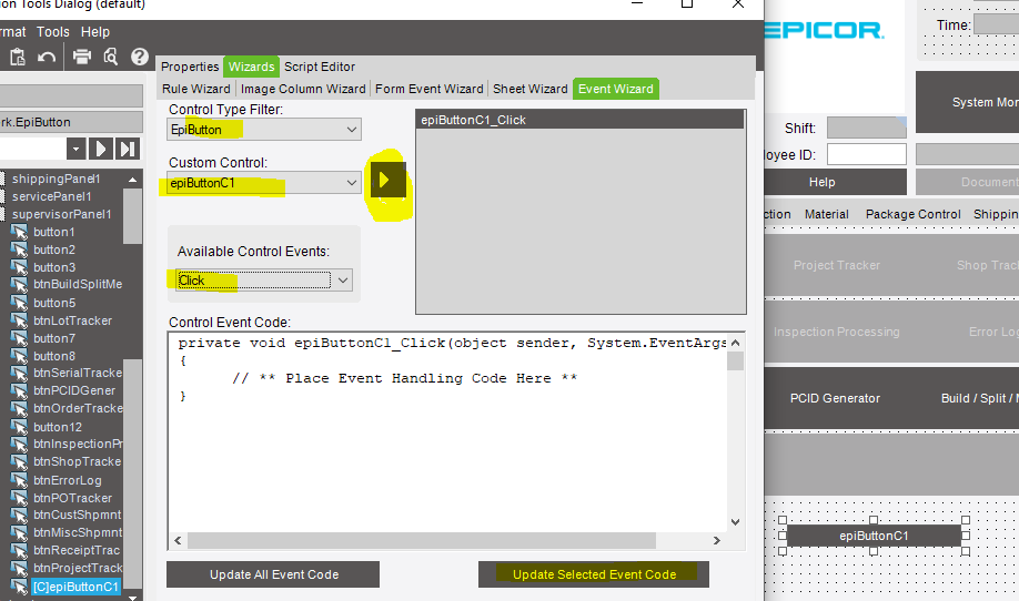

Here’s some screenshots on adding a click event to button (MES customization mode).
I added a new button and left it named epiButtonC1
Then you can add the code for a click event with the Wizards->Event Wizard tab:
Then after you “Update Selected Event Code”, it should be as easy as pasting 1 line of code in the newly created click function in the script editor:
ProcessCaller.LaunchForm(oTrans,“UDMESRMA”);
edit/warning: forgot “;” in below image. Be sure to include
Then save and restart MES with that customization selected (in customization mode), and try it out.

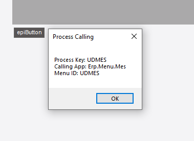

Made these Changes with the process caller, calling the UDMES which has the customization on it.
Then it gives me this error too.
I think this is not available in MES.
It looks like you may be trying to open MES again with that button, instead of the RMA tracker. You need to add the menu ID for the form you are trying to launch with that button, which would be one that opens the RMA tracker. In your previous posts you had created one with ID of UDMESRMA.
The only place you’ll need to reference the MES menu ID with your new customization (UDMES in this case) is in the sysconfig file.

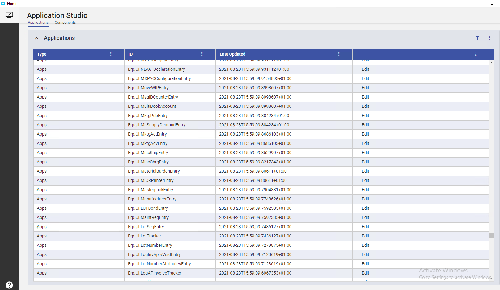

Is it possible to edit the Kinetic (10.2.700.22) version this way?
Unfortunately we do not have an installation of that version so I’m not sure. Maybe someone else can chime in?

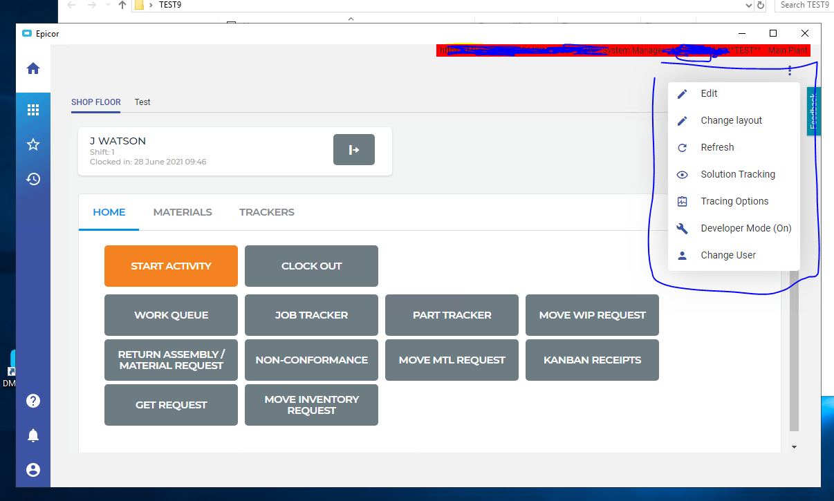

In the Kinetic version you would just access the Application studio by clicking on the dots in the top right corner.
I think maybe you are talking about the new version.
We are using Epicor 10.2.700 i guess it’s different in this version.
No MES in application studio.
